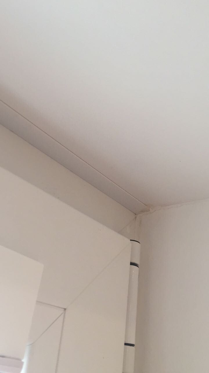

Dear Sir or Madam, I plan to install the roller shutter control from Lupus to operate my roller shutters. Our house is already equipped with a Lupus XT2.
I have a very basic question: how is such a roller shutter box opened? It seems to be a flush-mounted box with two parts?
I want to install the actuator there due to limited space in the electrical control box.
Thank you very much in advance for your support.
Images are attached.
Michael

Is it not possible to install the actuator directly at the actual switch or push button?

Hello Mastermind1, thank you for your feedback.
Unfortunately, no. Although the boxes are 7.5cm (3 inches) deep, almost all of them contain so many cables that there is no space left for the actuator, and I cannot or do not want to deepen the boxes because I would have to move quite a few cables aside.
The effort required for the roller shutter housing is also very high.
As it stands today, I will proceed as planned: the Lupus will be used purely as an alarm system, and for the "smart home" functions, I will use the Homematic flush-mounted actuators. I will test this next weekend, meaning the actual control will be handled by the actuator :-)
