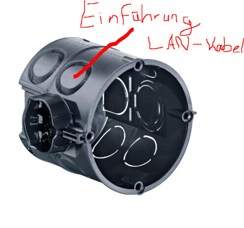

I am currently building a house and preparing the electrical installation.
My questions:
1. When installing network outlets, are standard deep flush-mount boxes sufficient? And is it acceptable to route the network cable through the middle cable entry points rather than the lowest ones (see file)?
2. Throughout my house, M25 conduit is used for wiring. If I have five cable entry points in a flush-mount box, can I still use deep flush-mount boxes, or should I rather use device connection boxes such as the Kaiser model with item number 1069-02?
My questions:
