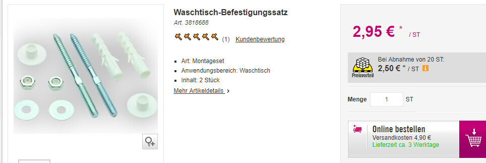

nordanney11 Jan 2019 10:37Pound schrieb:
How should I install the new bolts? Would I have to chip off the tiles again for that? Why? Do you have a solid, masonry wall?
Then just cut off the old bolts and install the new ones accordingly. For that, you only need a drill and 2.95€.
nordanney11 Jan 2019 11:46Good luck with the tinkering or consulting a professional.
