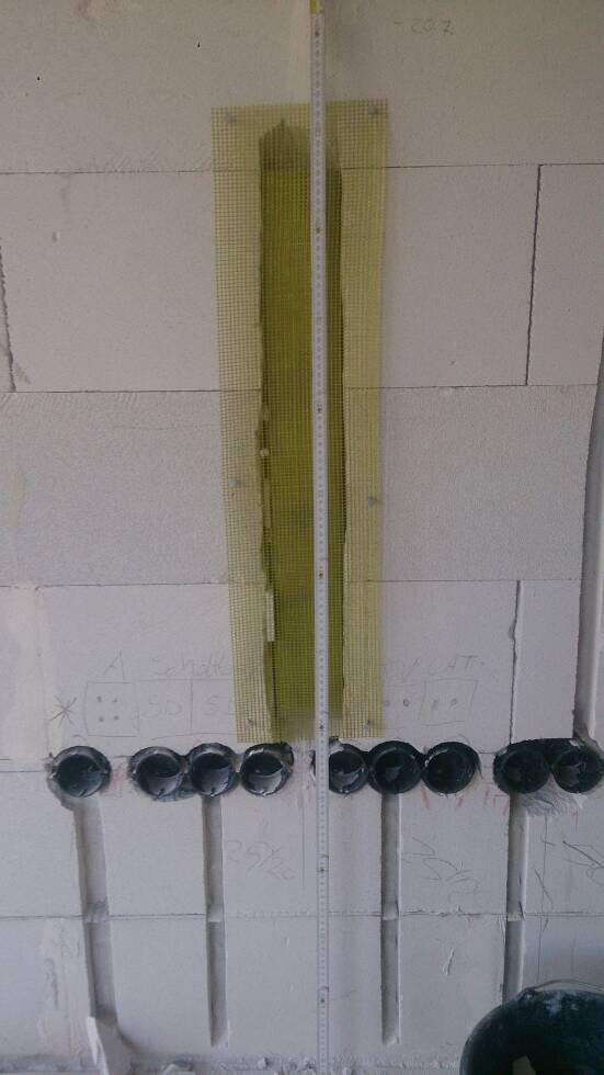

What is wrong with the (in my opinion most elegant solution) of embedding the cable duct in the plaster? This option offers the greatest flexibility, remains invisible, and allows for many cables to be routed through.
