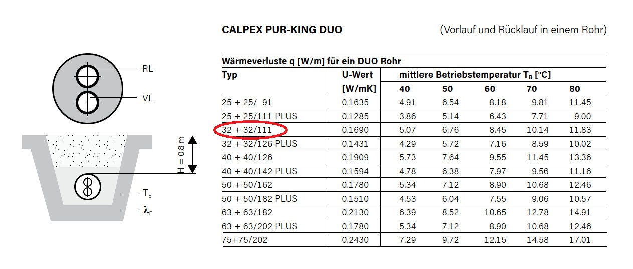

I have an 8-meter (26-foot) long heat transfer line from my house to the garage. According to the pipe manufacturer, the district heating pipe loses 5 watts per meter at a 40°C (104°F) supply temperature. What exactly does this mean, preferably expressed as a percentage?

So roughly calculate about 1% loss. That would be around 100 kWh (107.6 kWh) of heat, and if your heat pump has a coefficient of performance (COP) of 3.5, we are talking about 25 to 30 kWh (26.9 to 32.3 kWh) of electricity per year.
Or 3 watts of continuous electric power consumption throughout the year (our fiber optic modem, for example, has a standby consumption of about 4 watts).

I have exactly this kind of pipe underground. I marked mine in red. It will be an air-to-water heat pump. For this, I don’t need an indoor unit. Only the hot water preparation needs to be inside the house, along with all the pipes, valves, etc. I intended to put those in the garage.
CALPEX PUR-KING DUO: supply and return in one pipe; heat loss diagram.
