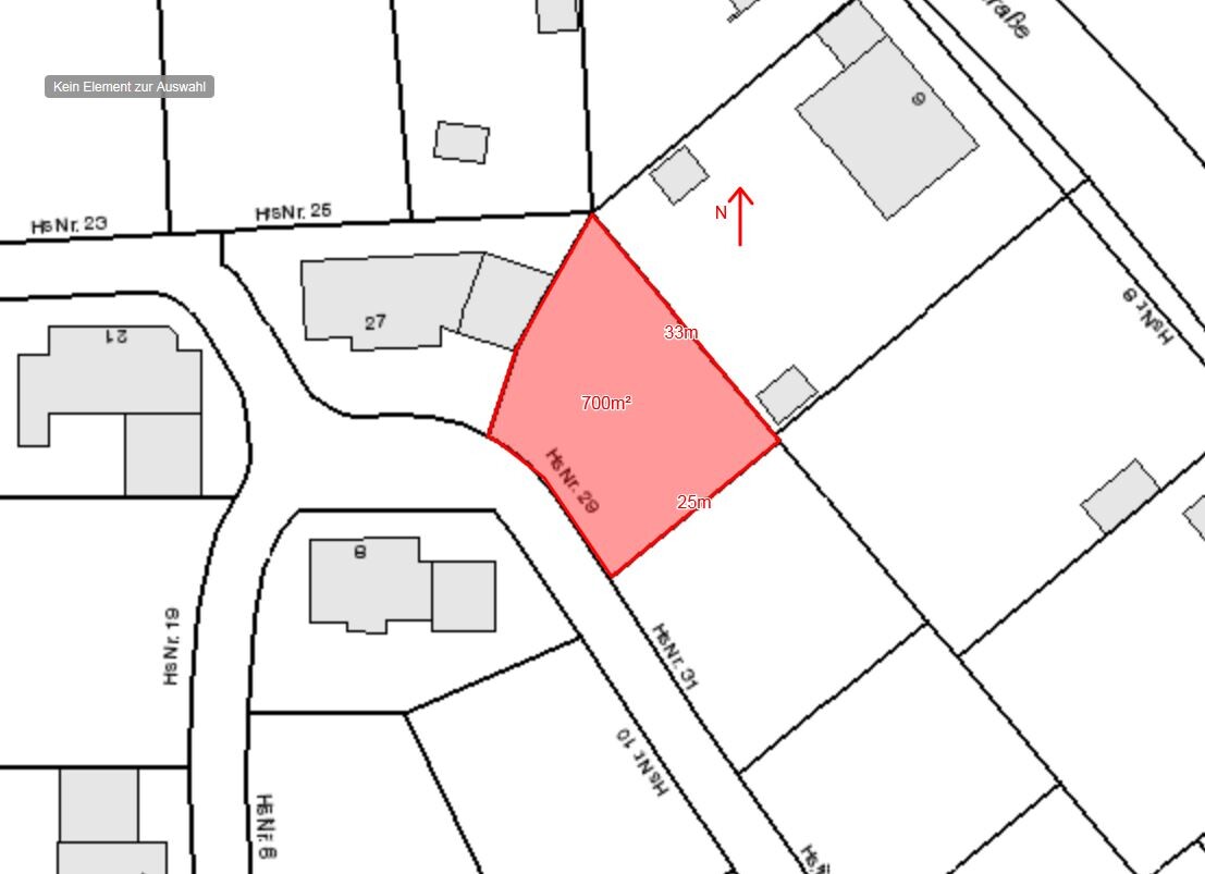

Artemis9027 Feb 2019 07:34There is no local development plan here regarding neighbors. On this hillside, there are also some "older" houses that are 1.5 to 2 stories high (viewed from the south). Unfortunately, I cannot increase my budget by $300,000 xD.
Alternatively, there is a Plan B. This would involve building on a different plot of land.
700m² (8,400 sq ft) flat ground
New housing development
Development plan requires a 3.5m (11.5 ft) setback from the street side and the opposite side
15m (49 ft) boundary setback
All roof types are allowed
The reason I even considered the hillside property is that it is a large 1250m² (13,450 sq ft) plot, which would be subdivided. The other half would remain undeveloped and might possibly be transferred back to me if I manage to be debt-free.
I just like the idea of standing in the garden and not immediately looking onto the neighbor’s property.
Can you explain to me the financial and technical differences between building a basement on a flat plot versus building an underground level on a hillside property?
Which location would you choose?
