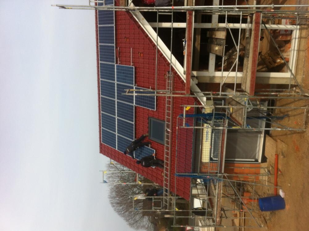

Regarding the roof color, unfortunately, we didn’t have many options because all dark and glazed roof tiles were prohibited.
We decided on a wine red color (see image below).
