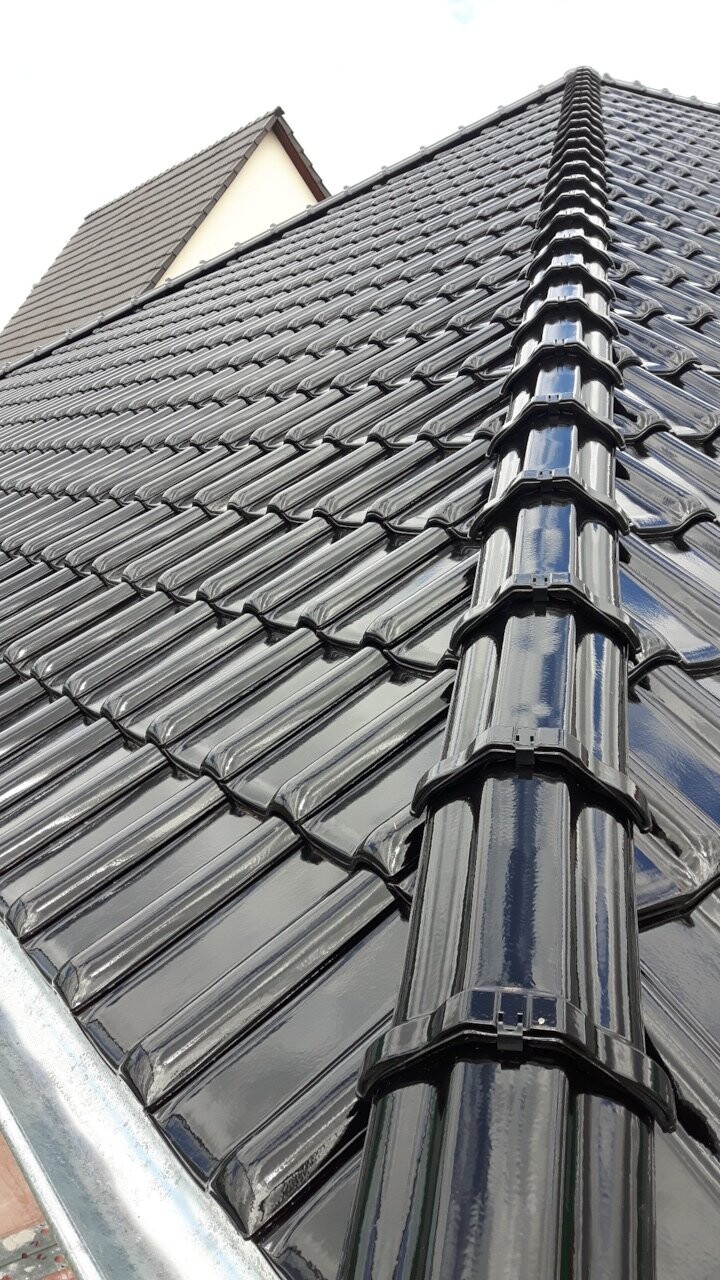

Fuchur schrieb:
For the smooth tiles, make sure that hooks can be installed for the photovoltaic modules. If I remember correctly, this is not easily possible with all types.Our solar installer cut the necessary openings into the required tiles with a grinder. It worked without any issues for all of them. We also have "glazed" smooth tiles.Similar topics
