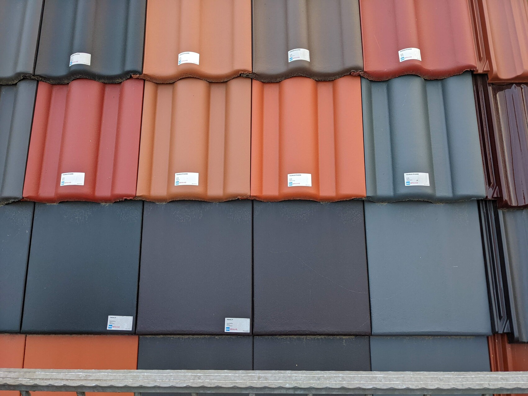

we are currently considering what the best roofing option for our new build is. A gable roof without dormers and no skylights.
Smooth clay tiles
or
Flat clay tiles or “Frankfurter Pfanne” (by this I mean curved roof tiles)
What are the differences or advantages and disadvantages?
Are there differences in weather resistance?
Do smooth tiles offer better protection against animals since they cannot crawl underneath as easily?
Can curved roof tiles better dissipate summer heat?
Approximately 90% of the south-facing side will be covered with photovoltaic panels. Does the choice of roof tiles affect anything regarding the installation of photovoltaic systems?
Thank you for your help.
