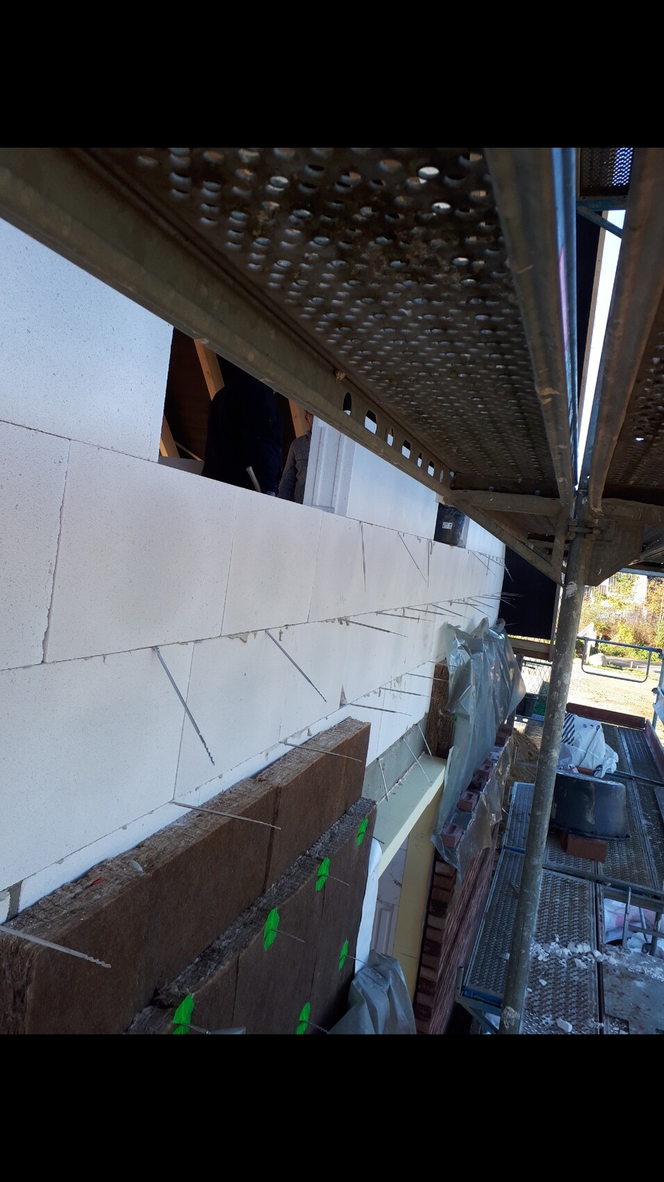

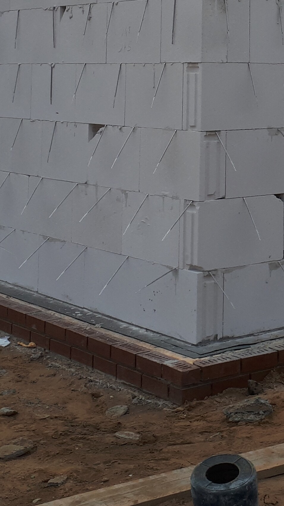

pffreestyler14 Oct 2019 13:31We have Ytong blocks. I would need to check the thermal conductivity (lambda) value in the calculations, but it probably isn’t an exceptionally good value since the building was constructed to meet basic energy-saving regulations.
We have a slab foundation with an 80 cm (31.5 inches) frost protection strip and 10 cm (4 inches) perimeter insulation at the base (Knabe clinker). On top of the slab, there are 17.5 cm (7 inches) of Ytong, 18 cm (7 inches) of mineral wool, a 2 cm (0.8 inches) air gap, and 11.5 cm (4.5 inches) of facing brick.
I’m not exactly sure about the specifics since we didn’t apply for a KfW loan. It’s somewhere between the standard energy-saving regulations and KfW 55.
