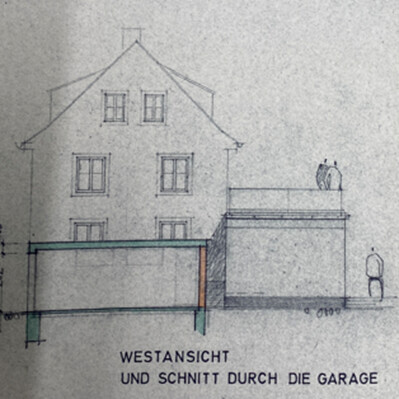

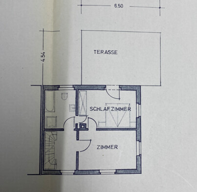

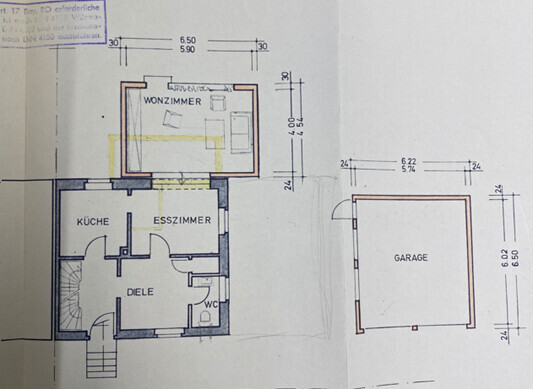

We are going to buy a semi-detached house built around 1920 with an extension from the 1960s.

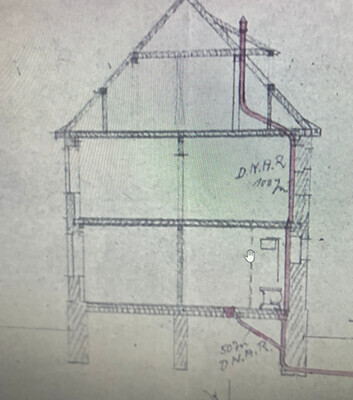

Below are a few drawings / pictures:

The extension from the 1960s measures about 6.5 x 4.5 m (21 x 15 ft) and is attached to the old house.
Regarding the extension, I’m not sure if it has insulation everywhere. The facade is made of hollow concrete blocks.
The extension includes a basement, which probably has no insulation on the ceiling. Currently, the basement is used as a hobby room but should remain unheated.

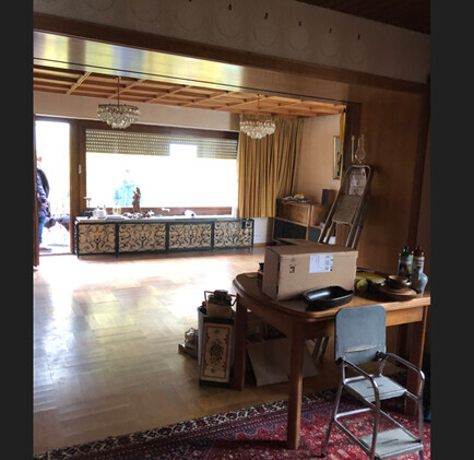

On the ground floor, the extension’s living room is connected to the main house through a large wall opening with the same wooden floor. However, the floor in the extension is concrete, while the main house has a wooden joist floor.

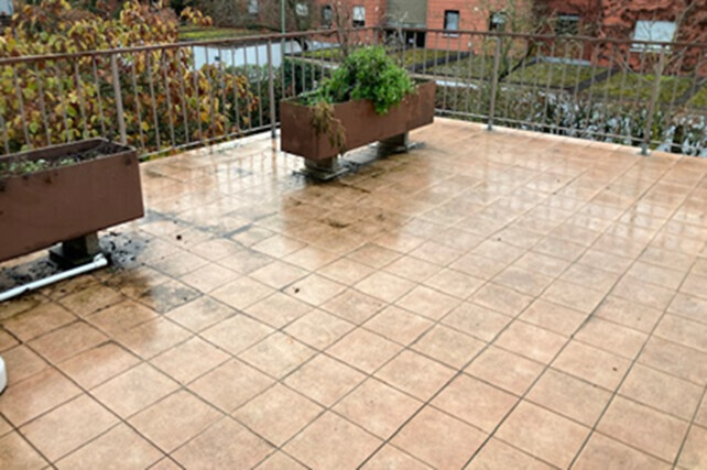

On the first floor, the extension is a terrace, covered on top with slabs and certainly sealed:
I suspect the extension is one of the building’s weak points regarding energy efficiency.
Before moving in, I would like to insulate the facade and, if possible, also the ceiling between the ground floor and the terrace. In the basement, I plan to add insulation to the basement ceiling.

How would you recommend insulating between the ground floor ceiling and the terrace? (inside vs. outside)

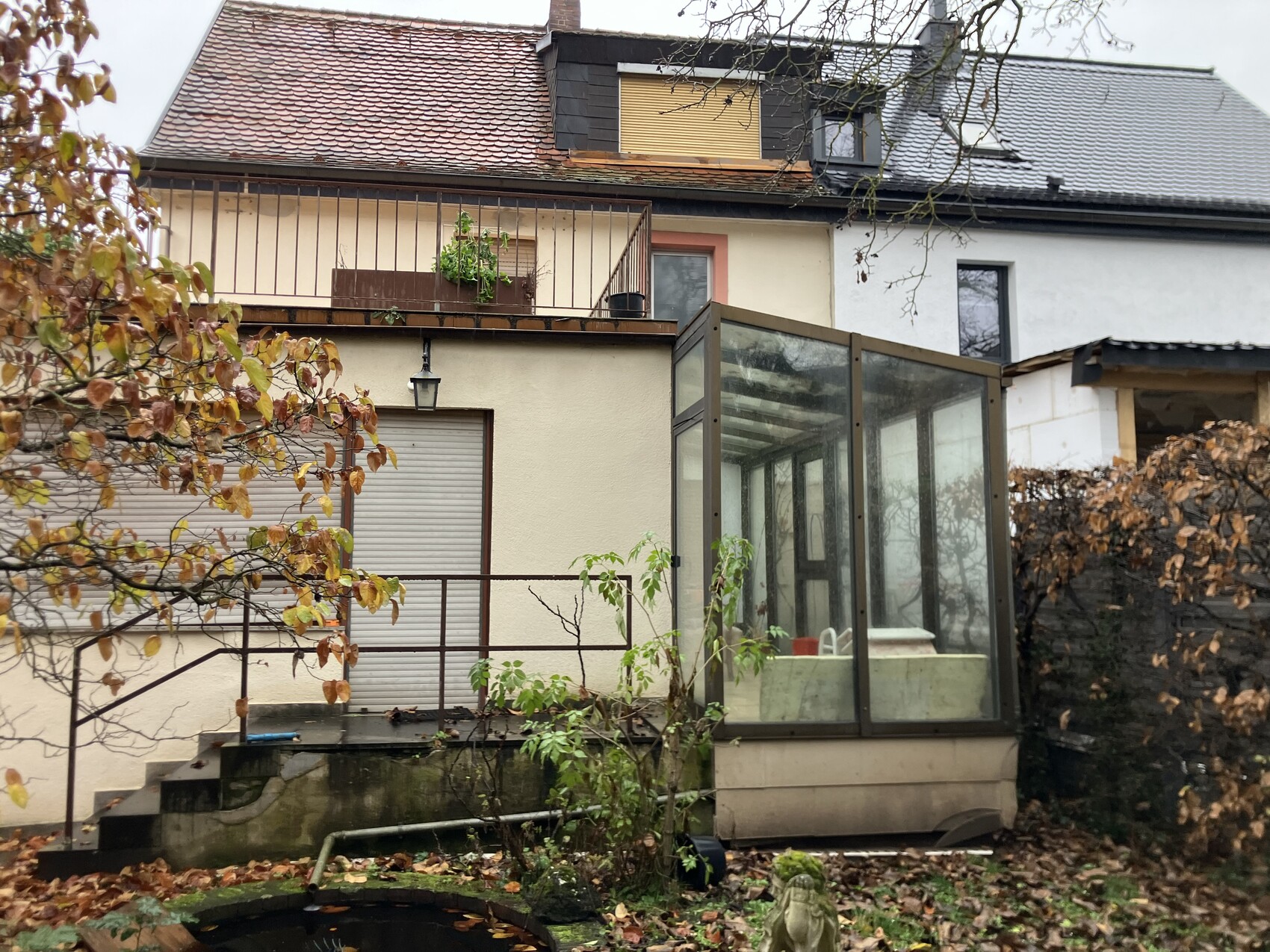

A similar question applies to the facade. External insulation on the garden side is rather difficult because a door to the conservatory would no longer be able to open. Also, the wall next to the conservatory cannot be easily insulated from the outside…

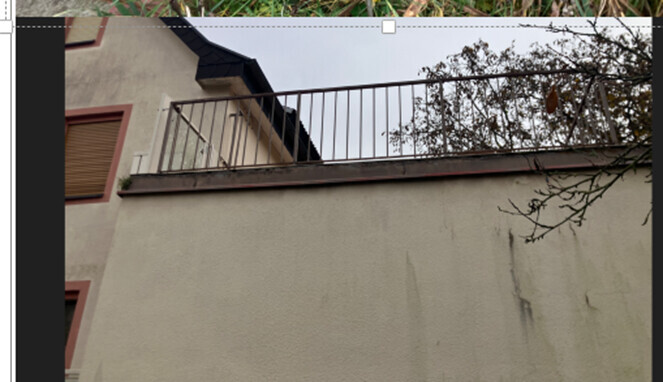

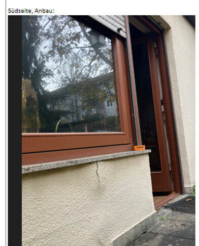

The following picture shows the south side of the extension. The plaster has a crack below the window.
Do you think this might be caused by moisture rising from the ground?
I suspect there is no horizontal damp proof course or insulation against the soil or the staircase visible on the right in the picture.
I hope these details help. Otherwise, I will provide more information if I know it.

You should only consider purchasing the property after an inspection by an architect or structural engineer experienced in older buildings. In addition to the condition of the building fabric and the resulting (energy-related) renovation requirements, several legally relevant building regulations must also be checked for such properties:
I suspect there will be 4 or 5 negative answers regarding this property.
- Does the extension have a building permit / planning permission?
- Does the extension maintain the 3.00 m (10 feet) boundary setback? If not, is there a neighbor agreement or a registered building encumbrance?
- Is the structural integrity of the terrace roof for use as a terrace verified and legally approved – see boundary setback?
- Is the conservatory heated or unheated? Is it generally eligible for approval within the setback areas to the neighboring boundary?
- Is the large wall opening between the dining room and living room structurally verified and legally approved?
