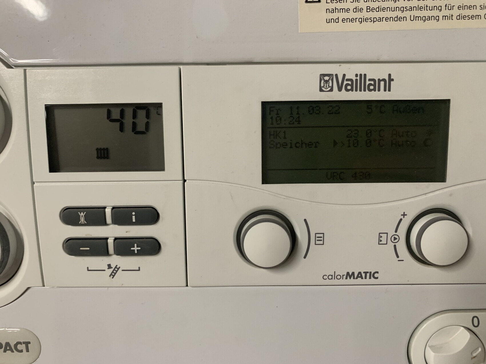

The flow temperature appears to be set at 75°C (167°F) The flow temperature is set to 75 degrees, just like in our system (we also have a Vaillant eco boiler). However, that is a gas condensing boiler. The modulation or control is handled by the heating system itself, as I assume it is an outdoor temperature-controlled heating system. The 75 degrees on the controller do not indicate much! We have similar conditions but are energetically worse off (built in 1920, double glazing, but no wall insulation). Our flow temperature at 0 degrees outside is about 46 degrees (115°F). This is not ideal for a (future) heat pump either. However, with consistent energy-efficient renovation and 33 cm (13 inches) radiators combined with photovoltaics, it is achievable.
HausiKlausi schrieb:
The flow temperature is set to 75 degrees Celsius (167°F), as it is in our case as well (we also have a Vaillant eco boiler). However, this is a gas condensing boiler. The modulation or control is handled by the heating system itself, as I assume it is an outdoor temperature-controlled system. The 75 degrees Celsius (167°F) on the controller doesn’t really mean much! We have similar conditions but are still less energy-efficient (built in 1920, double glazing, but no wall insulation). At an outside temperature of 0 degrees Celsius (32°F), our flow temperature is about 46 degrees Celsius (115°F). This is not ideal for a (future) heat pump either. But with consistent energy renovation and the 33/height panel radiators combined with photovoltaics, it is feasible.That would be an explanation. The 75°C (167°F) is only shown on the display when you adjust the controller – afterwards, the display reverts back to the normal reading, as mentioned above.
