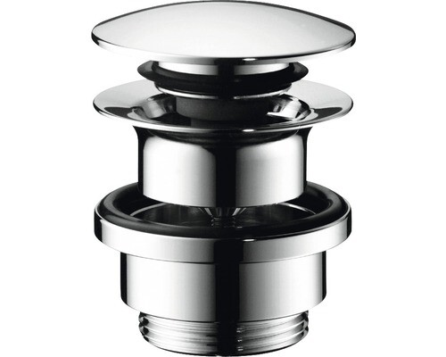

dr.becher
12 Jan 2018 10:49
Thank you all. Now I can confidently get started.
The following part will be used:
Close-up of a shiny metal part with a round disc on top and threading below.
so exactly the version that BOB described, with the long screw in between.
From what I have read, it is suitable for both versions and allows the overflow to drain as well.
Thank you very much.
BOB der 1.12 Jan 2018 12:09
So, it turns out to be with a screw after all... okay, I thought I was wrong because normally there isn’t one at the washbasin... at least with rod drives... with cable-driven ones, there are some installed.
No matter, the main thing is that you have it.
