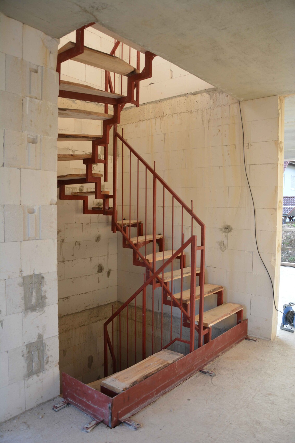

Our architect (who’s not exactly young anymore) told us during the planning phase that when he was a young architect, he learned from a very experienced architect: “Stairs should be designed so that when you walk up, your heart is on the same side as your line of sight up the stairs.” According to him, only left-turning staircases are correct in this respect. And that brings us to option 2. Now, have a look and see if you have “correct stairs” too ... 😉
Tolentino schrieb:
Then I guess I need to get dextrocardia...Or simply walk up the stairs backwards ... 😉BauFamily schrieb:
