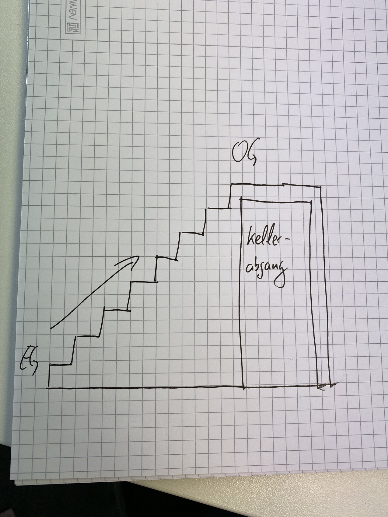

Myrna_Loy schrieb:
Why shouldn't that work? It's quite common in older buildings as access to the storage cellar.
The straight staircase is above the basement entrance, right? You don't want to access a straight staircase from the side, do you?
Exactly:
Hand-drawn staircase from the ground floor up to the basement descent, upper floor marked.
The basement stairs can be spiral or curved at the staircase landing from the ground floor.
Myrna_Loy
21 May 2021 10:23
You just need to be careful with the headroom when it comes to the basement stairs.
21 May 2021 11:36
Yes, of course that’s possible... I did ask specifically after all 🙄

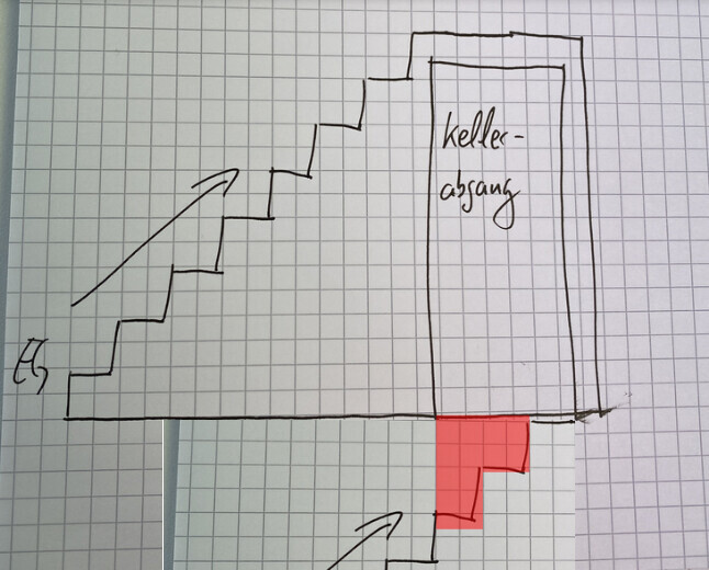

11ant21 May 2021 12:32
Myrna_Loy schrieb:
You don’t want to jump onto a straight staircase from the side?
Probably not intentionally – which is why it’s recommended not to contribute sketches to your own house plans:
Sketch of a staircase to the basement exit; step marked in red.
Myrna_Loy
21 May 2021 12:46
A quarter turn is sufficient.
