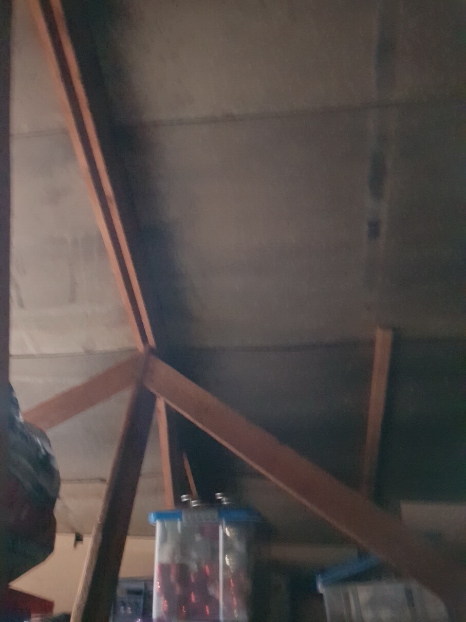

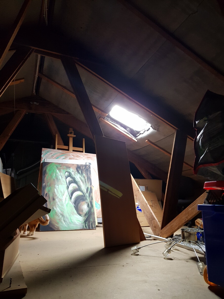

I’m not entirely sure what exactly is being shown here: 16 mm (5/8 inch) insulation seems unusual to me. From the pictures, it looks like either a purlin roof or possibly insulation applied over the rafters. What is the approximate year of construction and which federal state (region) is this in?
Also: what is the issue here? If the attic is only used as a storage space, I would consider the ceiling between floors to be a more appropriate insulation layer than the roof itself.

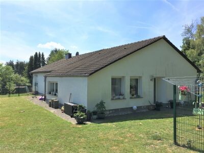

There should be 16 cm (6 inches) of insulation under the roof panels/floor. As far as I can see, there have been no changes regarding this in the Energy Saving Ordinance from 2014 to 2016.
The property is located in North Rhine-Westphalia.
Unfortunately, during the initial inspection, we were unable to look underneath or behind the panels.
I’m not sure if we are exceeding the thermal transmittance (U-value) limit for the top floor ceiling of 0.24 watts/(m²K). The house was built in 1969 and renovated in 2005, including this insulation. The architect/agent mentioned that the roof would need to be re-roofed and insulated to a higher standard.
I am inclined to think that it might be sufficient to increase the insulation from 16 cm (6 inches) to perhaps 20 cm (8 inches) or 24 cm (9.5 inches). If it can remain as is, even better. It’s just a significant amount of money.

With the existing 16 cm (6 inches) of glass wool insulation, assuming a thermal conductivity (lambda value / WLS) of 0.035 (standard for glass wool), you ONLY achieve a U-value of 0.21, thus meeting the requirements of the Energy Saving Ordinance 2014/16. All additional layers (chipboard panels, ceiling construction) reduce the U-value further, but not significantly.
In the pictures, it also appears that something has been installed on the rafters, which improves the overall insulation.
Increasing the insulation thickness on the floor further does not make financial sense here, since the area is currently walkable with chipboard panels. If some storage space is not needed, an additional 10 cm (4 inches) of non-walkable compressed felt/glass wool mats could be installed. Costs are around 5 €/m² (0.46 $/ft²). Walkable surfaces with chipboard panels would be closer to 20 €/m² (1.86 $/ft²) if done as a DIY project – these costs cannot be justified by the existing insulation and the resulting small additional energy savings.
If, unexpectedly, there is no insulation under the chipboard panels or if it is moist/damaged/perforated, a rebuild should be carried out. A thickness of 20-25 cm (8-10 inches) makes sense. Whether this should be walkable or not depends on the storage space requirements.
