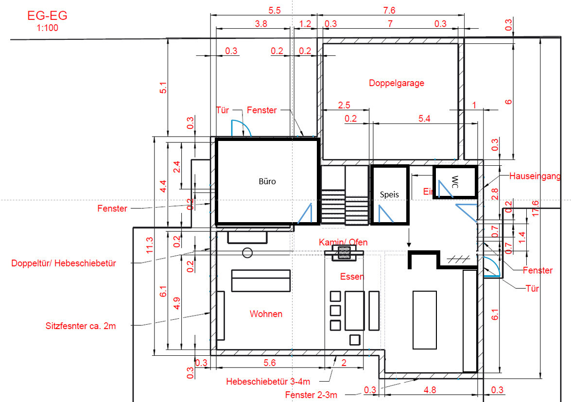

until now I have only been reading along here. We have now "spontaneously" bought a plot in the Würzburg district where I would like to build a single-family house next year (I have already started a thread for the architect search). So far, I am open regarding the construction method and the planning/execution of the project. Houses of friends have inspired me to roughly plan my "own" floor plan. However, I am not completely satisfied with it and would like to share my "requirements specification" and designs here. Maybe you can give me some helpful advice.
The main "problem" is the ground floor; I am confident I can accommodate everything I imagine sensibly on the upper floor.
If you have any questions, please feel free to ask.

Further wishes/special features/daily routine, also reasons why certain things should or should not be included: Piano space must be provided (take fireplace into account), a staircase from the living area would be nice (basement stairs possibly separate), a view from the upper stair landing into the ground floor would be nice, staircase only with straight steps (landing stairs or straight), terraces on the south and west sides (neighbors to be considered on south side), entrance area must be accessible both from the front door and the garage
Who made the plans: own design
What do you particularly like? Why? room layout (design 002) (approx. 13 x 11m (43 x 36 ft))
What do you not like? Why? space for the fireplace, hardly any south terrace, which can also be obstructed by neighbors
What do you particularly like? Why? larger south terrace possible (elongated design) (approx. 15 x 10m (49 x 33 ft)) (question is how large the room can be without support)
What do you not like? Why? space for the fireplace, where should the staircase go, kitchen island possibly too large as drawn

That is probably true, but...
...not a big deal: the “riser” in the broken roof ridge by itself is not so heavy that it necessarily requires a load-bearing wall underneath. Conveniently, from the perspective of the ground floor it would still be supported—regarding the upper floor, I won’t comment, and in that respect, the answer to Krüger’s question “is this art or can it go” is probably clear. A beam can also be installed. However, I mainly wanted to point out something regarding the upper floor. I do not consider myself a structural engineer. But the incorrect planning on the upper floor is obvious.
You have by far not made the most of the floor area. Therefore, I would seriously consider starting over.
An office only accessible through the living room? I find that uncomfortable. The upper floor is simply a big disaster…
Anyway, I have tried to make some improvements on the ground floor without major changes.
Suggestion:
- The arrow indicates a sliding door
- Since the kitchen was completely oversized, I took a bit of space from there
