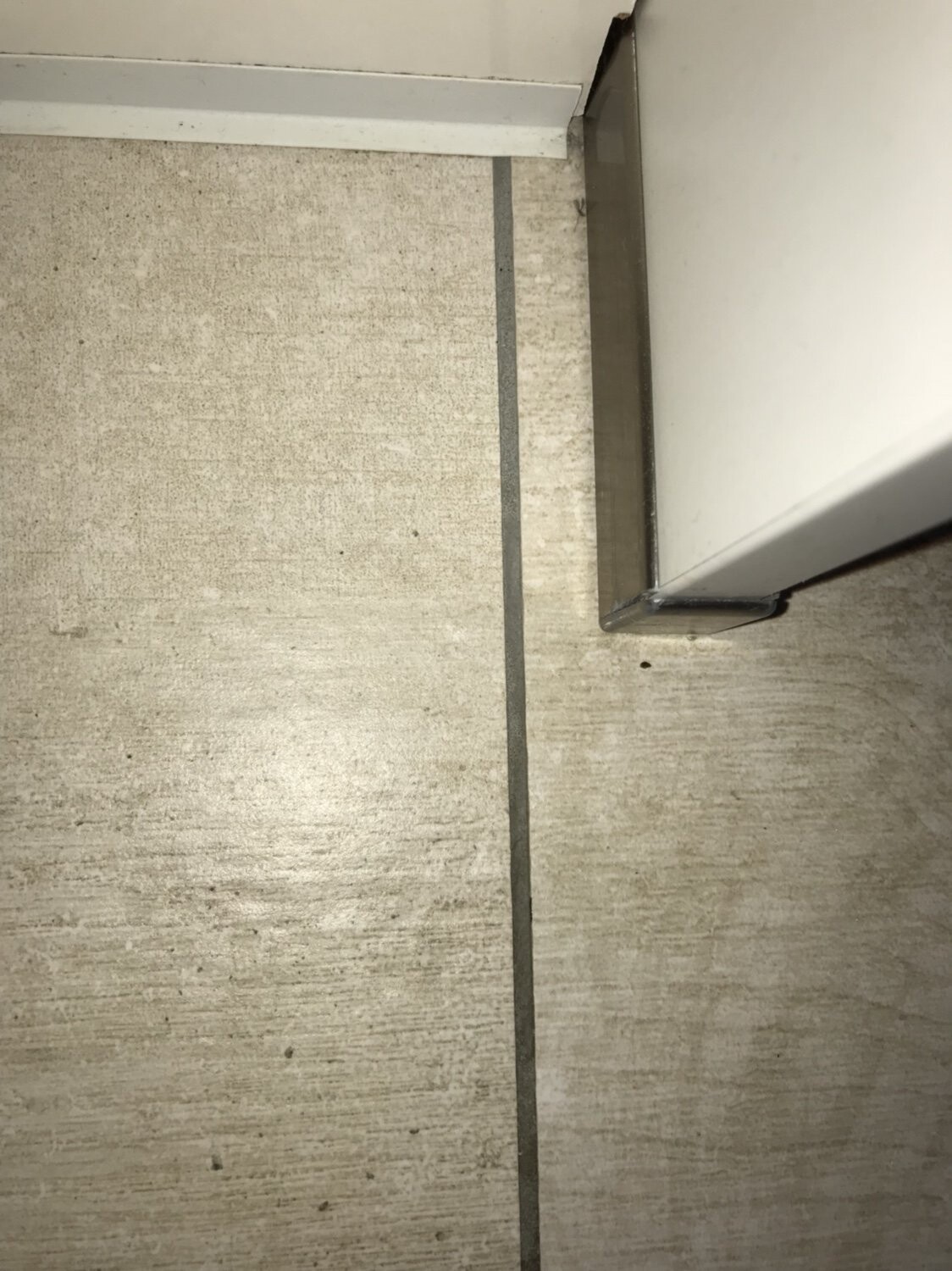

we have been living in a newly built rental home for 4 years now.
Now we want to have beige tiles again in our own house. Unfortunately, the grout, which was originally light gray, has turned completely black. Does anyone have tips on how to keep grout light and clean for a longer time in a new build? (Yes, brushing with a toothbrush helps, but you only want to do that once.)
Maybe some of you have experience with this. Thanks in advance.

hemali200314 May 2018 08:58I’m not familiar with them turning black like that... Maybe a bit patchy, but that dirty?
However, it might be worth considering epoxy resin joints.

Hmm, the grout doesn’t look dirty, just dark, and very evenly so. It probably isn’t due to insufficient cleaning. Otherwise, there would be lighter, patchy spots visible in the grout.
Our tiler said years ago that you should definitely avoid scrubbing the grout with aggressive cleaners or brushes. That’s when cracks would form, which would then trap dirt more easily. Our wider grout lines have only darkened slightly over more than 15 years.

I have found that the darkening of grout depends on the type of grout used. Higher-quality grout tends to resist dirt and residues from cleaning products better.
Friends of mine used the cheapest option, and their grout darkened and became stained quite quickly. Others hired a professional tile installer who used a high-end grout to match the very expensive designer tiles – after about 10 years, their grout has darkened slightly but still appears "gray" and not stained. The friends with the darker grout are actually those who clean very diligently. So, I can well imagine that the quality of the grout is a major factor.
Unfortunately, I can’t yet recommend which grout performs best – perhaps other users here have long-term experience to share.
