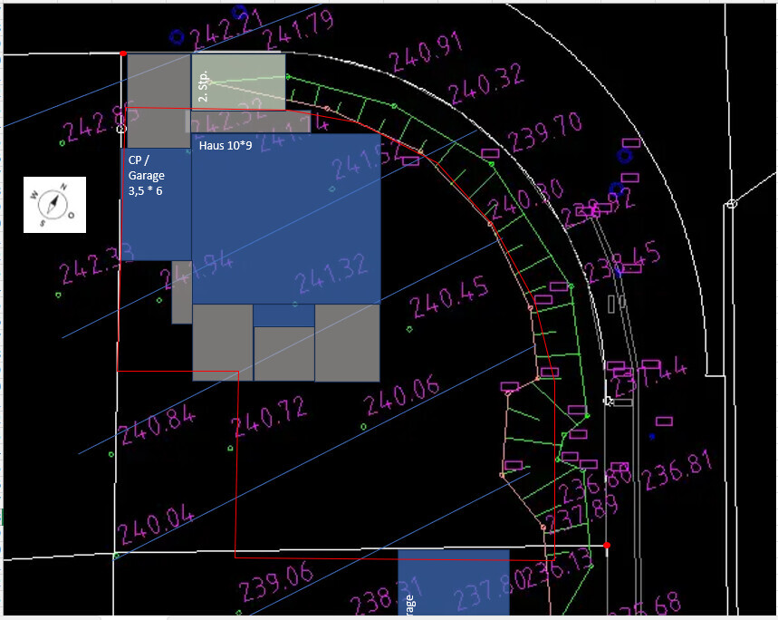

we have purchased a fully serviced plot of land from the municipality. I have already had it surveyed. The plot is sloped, dropping steeply at the lower right corner. After some consideration, I have identified two possible locations for the house (approximately 70 m² (750 sq ft) footprint with a basement, not yet finalized) with different advantages and disadvantages. Maybe you can help me decide between these options. The expected costs for the site work and earthworks for the two options are the main focus.
Option 1: The house is located at the upper corner of the plot, with the basement fully underground. Here, about 4.5 m (15 ft) of hillside at the lower right corner need to be retained.
Advantage: The house sits high, likely offering a better view over the valley, with a south-facing garden (is this an advantage?)
Disadvantage: In my view, the lower right corner looks unattractive. The steep slope is probably complex and costly to build and maintain.
Option 2: The house is placed at the lower right corner. Here, the house and the hillside garage retain most of the land. The remaining retaining structures are then moderate in height.
Advantage: It appears better integrated into the terrain, with no unnaturally high support structures. Large courtyard on the eaves side.

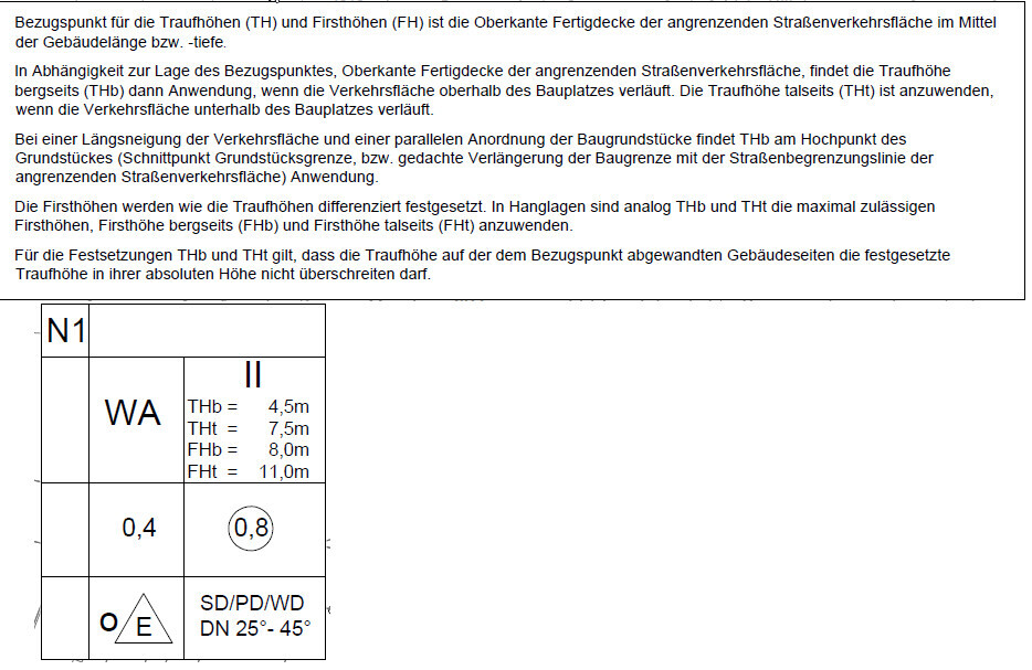

Maximum heights / limits: eaves height 4.5 m (15 ft). The reference point is not entirely clear to me, see excerpt from the development plan

hanghaus202318 May 2024 14:22I would design it according to my preferences. Unfortunately, the surveyor did not measure the curb line. You should ask them for the elevation at the reference point in the west. I would then position the house and garage 20 cm (8 inches) above the reference point's floor level. This way, you will still have a respectable knee wall height.
How is your neighbor to the west building?
hanghaus202318 May 2024 14:33How deep is the shaft on the north side of the property? Is there also a sewer shaft in the southeast? Are there any restrictions regarding land shaping and retaining walls?
