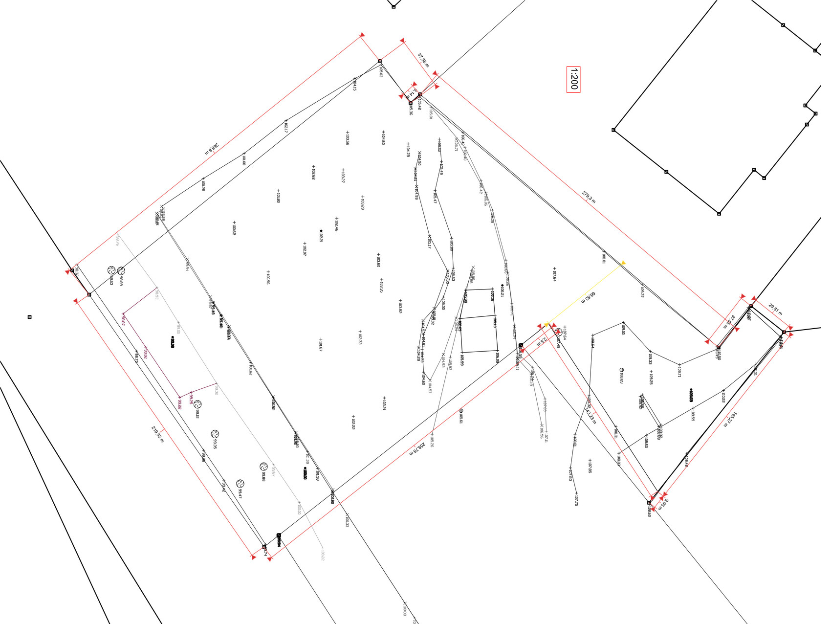

Plot size: 774 m² (8,330 ft²)
Slope: 13%, as shown on the site plan
Floor area ratio (FAR): 0.4
Building coverage ratio: 0.5
Building envelope, setback lines, and property boundary: 11 x 15 m (36 x 49 ft), as shown on the site plan

Unfortunately, I can’t accurately represent the terrain in the design software. If needed, I can scan a section drawing to make it clearer. The garden to the left of the house and above the external staircase will certainly be designed differently later. So far, there is no lawn area marked yet.

Thank you for the note, haydee. 13% is not correct; it is about 27% at the steepest point!
The private driveway to the south provides access to the property. On the other side of the private driveway, there is an additional parking space, as shown in the very first overview image.

Do you have the exact elevation profile?
You are digging the house into the hillside, which will be quite expensive.
You are planning to have a large private driveway on the south side.

Attached are the exact elevation details of the plot.
The private driveway has always been this way and cannot be changed since it serves as the main access route for two other properties.
We do not want to swap the living and sleeping areas because we want the living area to have direct ground-level garden access facing southwest.
