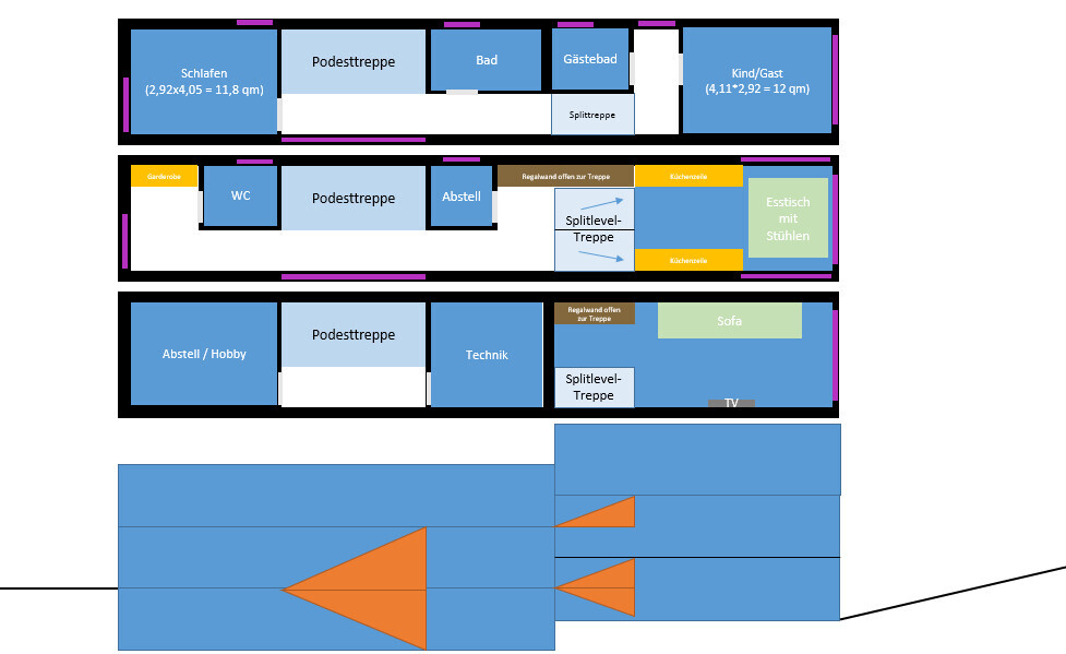

BeHaElJa schrieb:
House width 4.5 m (15 feet) minus 2 times 29 cm (11.4 inches) wall thickness = 292 cm (115 inches) interior width – definitely not perfect, but an idea:
*Edit* with 3.92 m (12.9 feet) interior width it naturally becomes easier. Mentally just stretch everything 1 meter (3.3 feet) wider (1 m more at the top of the plan) Thanks for the idea.
Yes, at 3.92 m (12.9 feet) it will be a bit easier.
I really like the idea and just hope I can achieve something with the building authority / planning permission office. Then I will certainly incorporate some of your thoughts.
