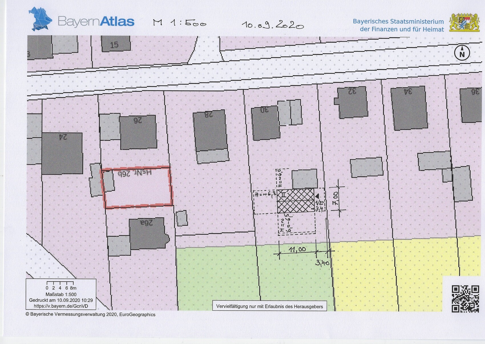

We are planning to build a house in the second row, next to the existing garages, which results in a narrow building envelope (see plan).
There is no zoning plan, so the only guideline is the neighboring buildings.

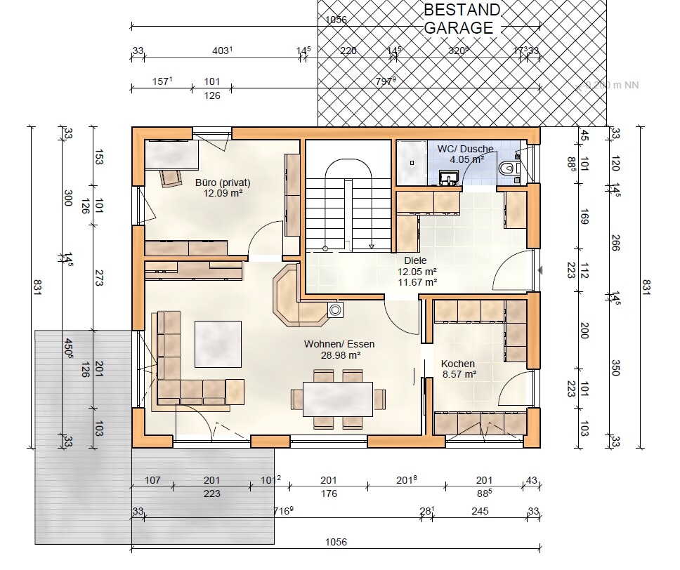

The attached floor plans are for reference only, as the first draft from a builder seemed too bland for us.

Plot size: approximately 550 - 750 sqm (6,000 - 8,100 sq ft), but the building area is limited Whether something can be carried out depends on certain measurements. You can’t just extend a house or add a bay window however you like.
So, measurements are necessary!
Edit: I found it:
additional requirements: maximum length 11 m (36 ft) and width 8.5 m (28 ft)

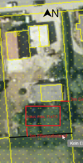

How is the existing garage being used? I don’t see any driveway on Google Maps. Where are the paths to your house, and where is the carport supposed to be? The access for the "Baumeister-Haus" would go right through the garden of the existing house. Option 2 might offer more privacy there.
@Romeo: The garages are currently not used for a car but only for trailers, car tires, garden furniture, etc.
Ideally, the entrance should be on the east side, with the path to the house running along the east boundary of the property towards the south.
The floor plan of the builder’s house would need to be mirrored accordingly, but unfortunately I’m having trouble fitting that properly on paper :-(
@ypg: The length of the new house is limited to 11m (36 feet) because otherwise, the house in the first row would lose too much southern exposure.
The exact width still needs to be measured, but the maximum should not exceed 8–8.50m (26–28 feet), otherwise the setback requirements on the south side won’t be met.
stoecklj schrieb:
The garages are currently not used for cars but only for trailers, car tires, garden furniture, etc.And they are so valuable that they just have to stay there by divine right?https://www.instagram.com/11antgmxde/
stoecklj schrieb:
@ypg: The dimensions for the new house are limited to 11 meters (36 feet) in length because otherwise the house in the first row would lose too much view to the south.Yes, I have already noticed that.
Still: You need to prepare something for us and not expect us to measure your tiny sketch floor plan using cross multiplication and distance calculation.
To approach this creatively, a simple drawing with dimensions—width, length, driveway, existing structures, etc.—is necessary.
Notes like "this is an old garage, which will remain" should be available for all parts of the plot.
I’m starting to question these garages, why keep a garage or garages as large as a duplex on the plot just for garden furniture and tires?
Your new building barely leaves any garden space and is already right up against the neighbor’s property!
Your attachments are quite small, barely readable.
Your "3 meters" vary by almost twice as much.

Try flipping your design to the mirror image, and place it at the plot scale—then you’ll see how much space is really left.
And if you can’t manage that on the computer, just use graph paper and a pencil.
stoecklj schrieb:
Number of parking spaces: available at the driveway from the northAnd then you want to use the driveway at the old garage to get to the front door? That could become very tedious when carrying drinks.
