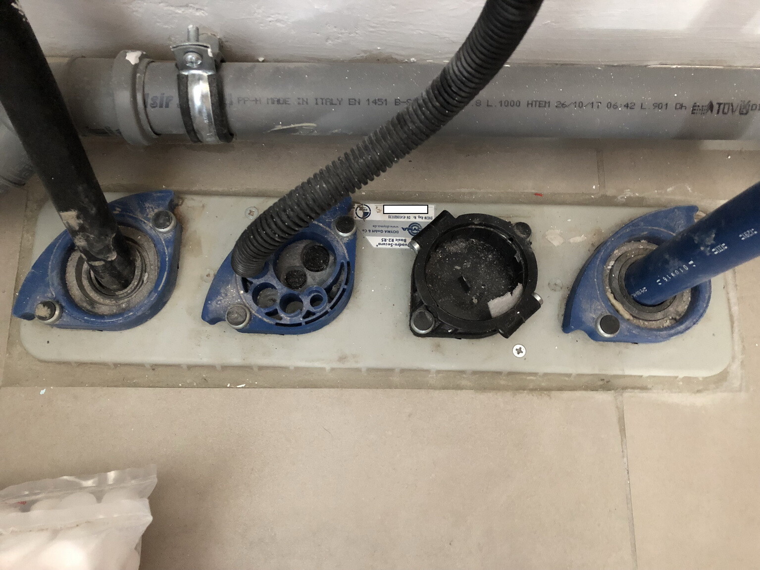

If I can use the existing one, I don’t need to drill another hole.
How is such a shaft usually constructed?
I didn’t have the chance to take a look at it.
Is it a wide slot, or are all the holes visible in the cover plate generally drilled through the floor slab?
Then I would only need to push a conduit through and pull it out at the bottom in the pit.
I was finally able to open the black cover.
There is already a conduit running through the building permit / planning permission and, alongside the other connections, it lies beneath the house.
I only need to connect this pipe to the conduit for the telecommunications fiber.
