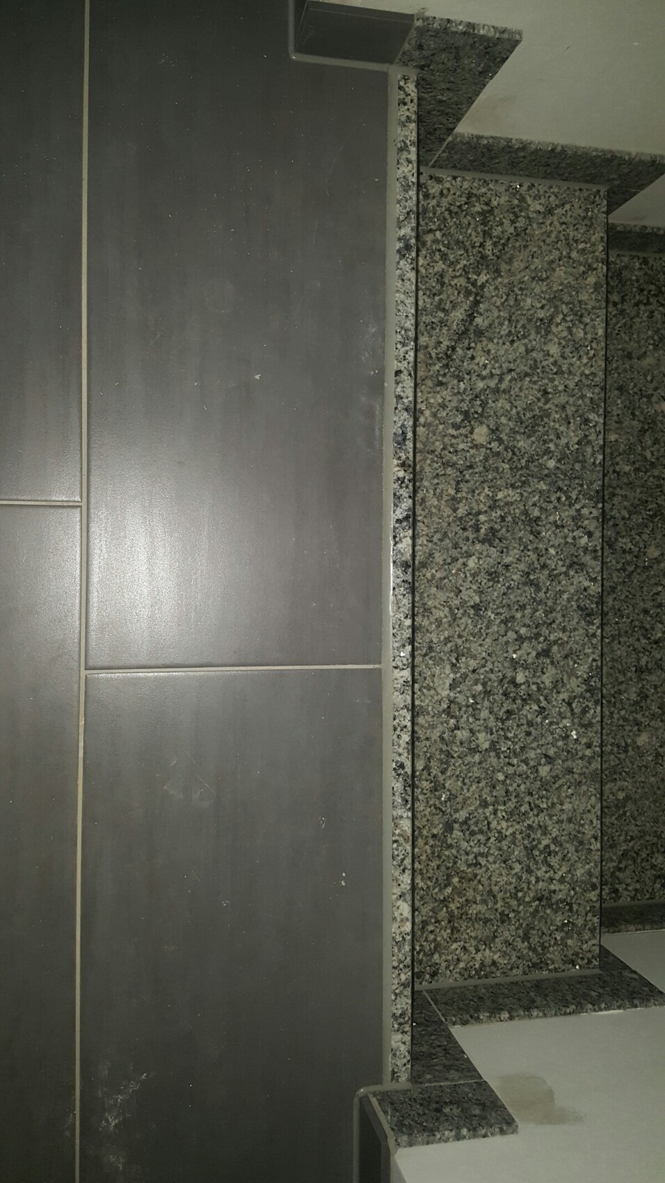

What do you think about the solution for the top step of the staircase? Is this an acceptable approach? Usually, the tile should extend all the way to the edge, but is this also up to the discretion of the tiler? By the way, he also installed the stair treads.

Actually, the tile should go all the way to the edge, or is that up to the tile setter’s discretion?
It looks nice. The question is what was agreed upon. There are many possibilities.
Neige11 Jul 2016 13:04
This is done properly, although in my opinion it is not aesthetically pleasing. Here too, the question of whether the execution was agreed upon must be allowed.
Koempy11 Jul 2016 13:05
How did you envision the top stair step? From a technical point of view, it looks more than correct.
