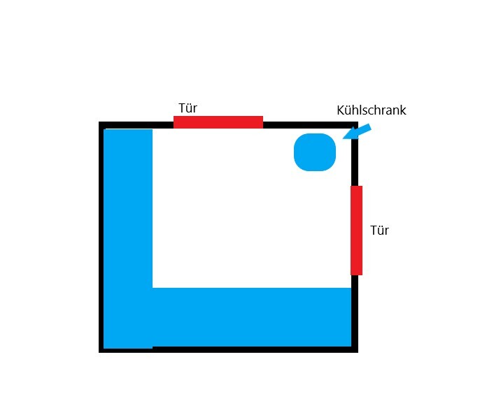

The kitchen was planned with the suggestion to place the heating in the baseboard. I made a small sketch to show how the setup looks in the end.
Where else would you place a heater here if not in the baseboard? The blue area is the kitchen in an "L shape," with two doors and the refrigerator in the corner.

lastdrop9 Dec 2019 09:50
Is this an outside corner? If so, I would definitely recommend installing a heater... if not: still.

9 Dec 2019 09:55
@lastdrop: Yes, an outside corner.
I will wait and see what the heating engineer says. From what I gather from the opinions here in the forum, most seem to prefer some kind of heating system, regardless of the specific type.
KingJulien9 Dec 2019 09:55
X_SH5_X schrieb:
Where else would you place a heater here if not in the plinth?
Tricky. Fridge in the row, a 60cm x 60cm (24in x 24in) unit in the corner where the fridge was planned, and then between the door and the unit? It just has to suit your taste.
