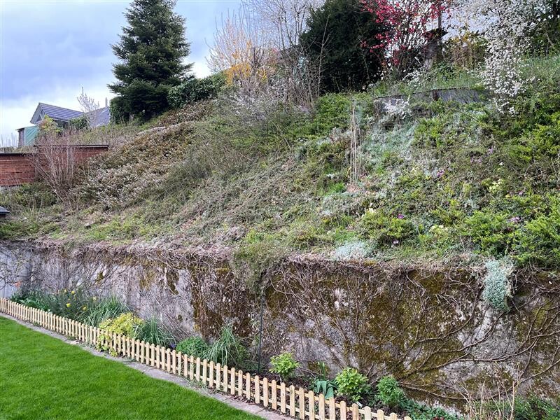

Hello everyone, I want to add some (not continuous) terracing on a steep slope to better plant willows and other vegetation. The slope is stable, with light ground cover, very dry, rocky, and steep. The neighbor has already nailed boards at the top boundary, and my property starts from there. This is how it looks:
Garten mit steilem bepflanztem Hang über einer Steinmauer; am Fuß Holzzaun und Gras.

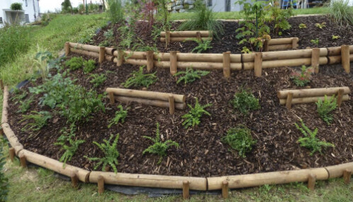

I want to achieve something like this:
Gepflegtes Gartenbeet mit Mulch, Holzbegrenzung und jungen Pflanzen im Vorgarten

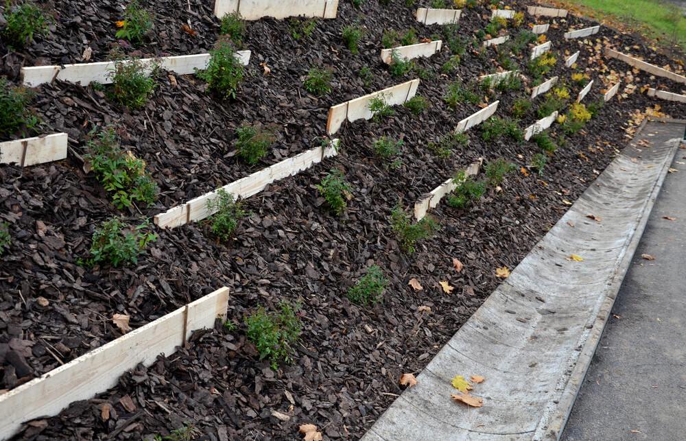

or something like this with boards
Hangterrassen mit Holzleisten, Mulchboden und kleinen Grünpflanzen neben dem Gehweg.
My idea is to use screw anchors instead of metal rods or wooden stakes.
What do you think? Should gravel and drainage membrane be placed under the boards or black locust posts?

I’m not entirely sure why you want screw anchors. They are usually used as a substitute for pier footings, not for posts.
Option 1 looks better visually; the one with the boards seems very makeshift. If you use locust wood (Robinia) for the posts, it will last a very long time.
