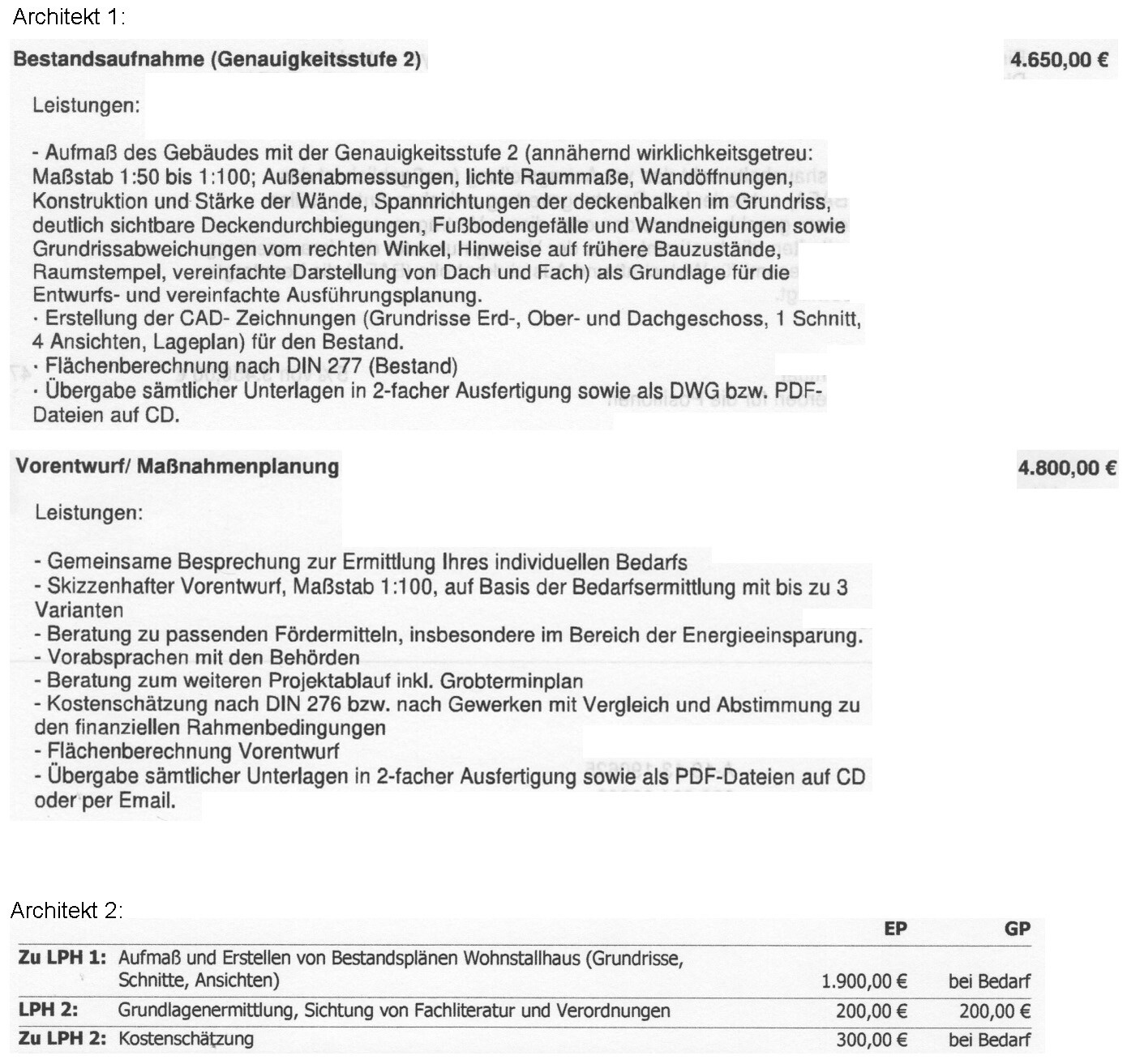

We have already had two architects visit the house, and they provided us with cost estimates for design phases 1 and 2.
However, the quoted costs vary significantly (see attachment). How can this be?
Zwei Architektenangebote mit Bestandsaufnahme/Vorentwurf und Preisen 4.650€ bzw. 4.800€.
11ant10 Aug 2020 23:09
Well, then everything is clear.
Egon der 3. schrieb:
However, the estimated costs vary a lot (see attachment). How can that be?
The reason is obvious: the thoroughness of the quote preparation differs even more significantly than the prices. Well, since you haven’t known me for long, I’ll save you the trouble of looking back – but my loyal readers probably don’t need to be reminded that I would definitely prefer the thorough professional over the one who just skims through.
michert
11 Aug 2020 10:15
For 2400€, I can hardly imagine that you will get a reasonable service. At common hourly rates, that amounts to about 20 hours of work. How can proper measurements be taken within that time?
T_im_Norden
11 Aug 2020 15:03
Timber framing and historic preservation, and one person wants to look for specialized literature.
Let me ask, do you have any experience with this kind of work?
References?
That would be more important to me at first than the price difference, especially considering everything you plan to do.
