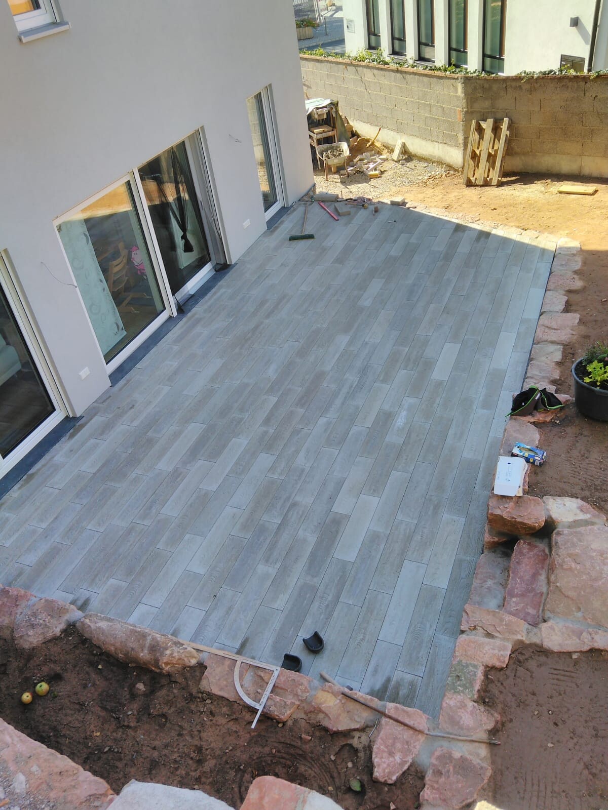

We basically have window sills
Newly laid terrace with light gray rectangular tiles by the house; construction tools in the background.
Pinky030123 Jun 2020 16:50
Cool, thanks a lot! I just found something similar online, but yours look nicer. Do you happen to know where they are from or what they are called?
haydee
23 Jun 2020 16:51
What about the windowsills? No, they were provided by the general contractor.

23 Jun 2020 17:08
The calculation lists Granit Delia Light. When I search for it on Google, the color doesn’t match. I don’t have the sample selection on hand at the moment.
