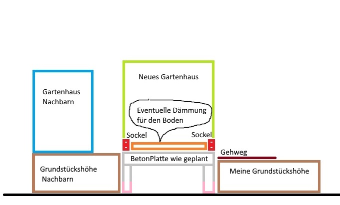

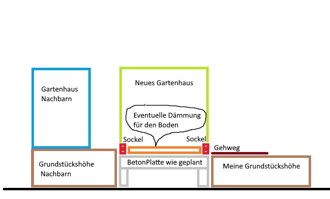

Yesterday, I checked the slope and how level everything is using a spirit level and battens. A small issue came up for me: The site slopes more than I thought, and overall there’s not much space available.
The back is significantly higher than the front. Since I want to build a base wall from 1–2 rows of blocks, I’m not sure how high or deep I can make the concrete slab – also considering how much water pressure there might be.
It’s a bit hard to explain, so I made a simple drawing using professional paint software 🙂
My main concern is whether I could have problems if the slab is lower at the back than the surrounding ground and then the base wall sits at ground level. Could that lead to issues with water buildup from rain? Although with the roof overhang and gutters, very little water should reach that area.
I naturally prefer the left option because with the higher option I would need to cover the concrete slab a bit at the front.
Also, I can’t raise or change the front walkway.
