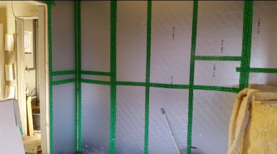

tomtom7914 Jul 2021 08:29
K1300S schrieb:
With insulation on the inside, or how should I picture that?
Yes, on the inside—you naturally lose interior space.
These are 8cm (3 inches) boards with aluminum foil, but don’t ask me for the name anymore. On top of that, battens, OSB, and drywall.
Construction site: Insulation boards on walls with green tape; tool area on the left.
