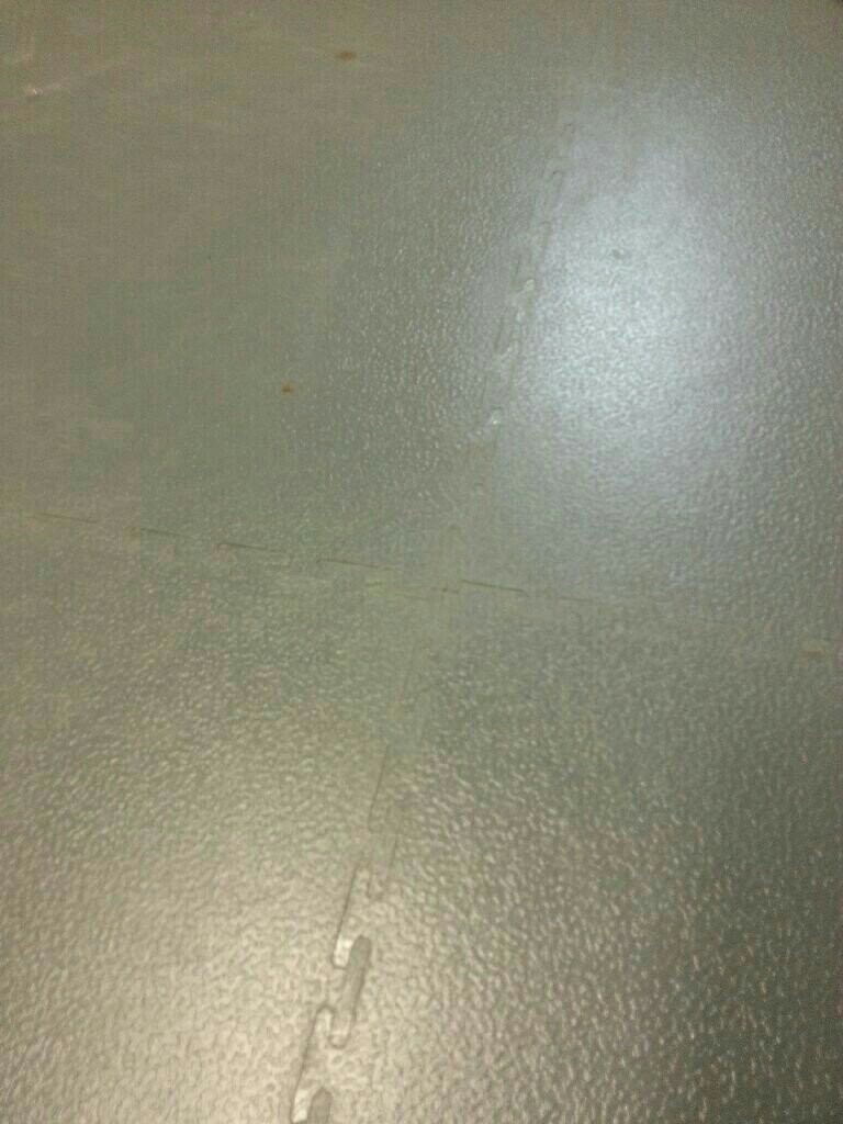

For a similar reason, we installed so-called flexi tiles in the basement. Maybe just try searching for them online. If anyone is interested, I can also take a photo in the basement this evening.

Hello Sylvia,
thank you for your pictures. It looks quite good. However, it’s not exactly cheap. Do you have any experience with the hooks on the edges on uneven floors? Are the panels flexible enough to adapt?
The manufacturer advertises the panels as waterproof. I assume they don’t let any water through, right?
Michael
