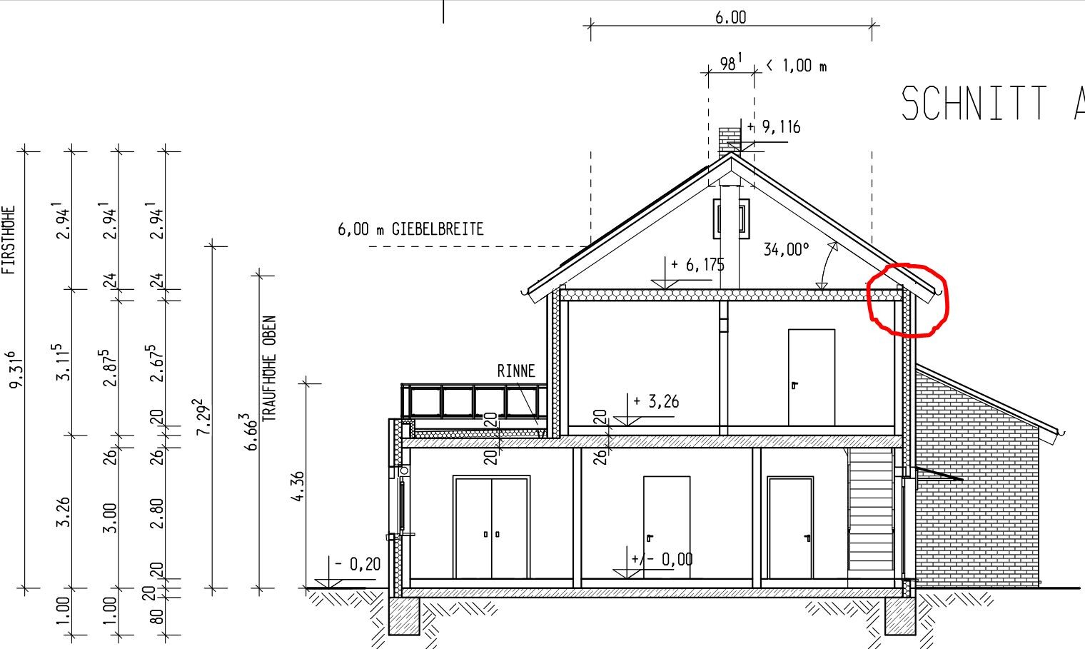

Alternatively, the architect suggested “setting back the northeast corner of the upper floor” and building a flat roof on the concrete slab above the ground floor at this point – at least visually, I find this questionable, and it might also create a thermal bridge or a potential point of moisture ingress later on.

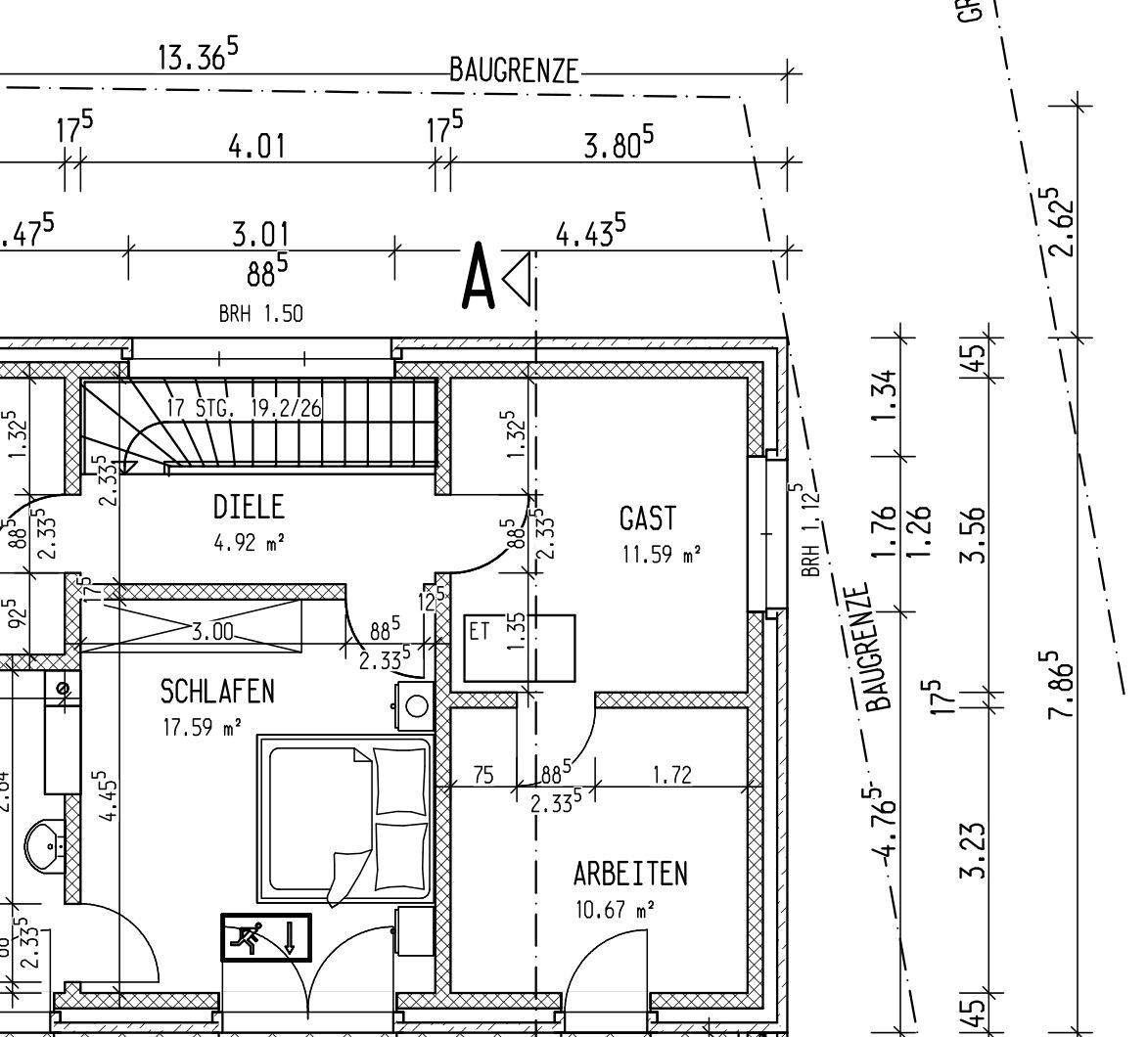

Upper floor, whose corner would need to be “set back”:
Section of the house viewed from said “corner,” with the problematic high corner circled here:

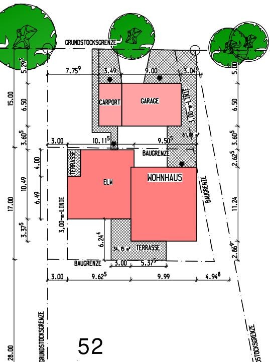

Plot/building window:
Thilo197910 Feb 2022 17:54RomeoZwo schrieb:
Could the floor plan of the granny flat be adjusted so that the granny flat becomes 0.33m (1 foot) narrower, and the whole house shifts slightly to the left?Awesome! That’s a really great idea. We still have some space in the building envelope to the north and south of the granny flat, so the few lost square meters can be added there. The terrace of the granny flat on the west side, which we thought had to stay within the building boundaries, is actually allowed by the county to extend beyond them. This means we can make the shift without making any rooms in the granny flat smaller.
I’ll post a before-and-after of the ground floor once our architect has made these changes.
Many thanks for this simple but effective idea, which also means that nothing about our building section needs to change except that it moves 33cm (1 foot) to the left. We had already been so focused on recessing corners and all kinds of other details that we couldn’t see the forest for the trees. Thanks so much!
