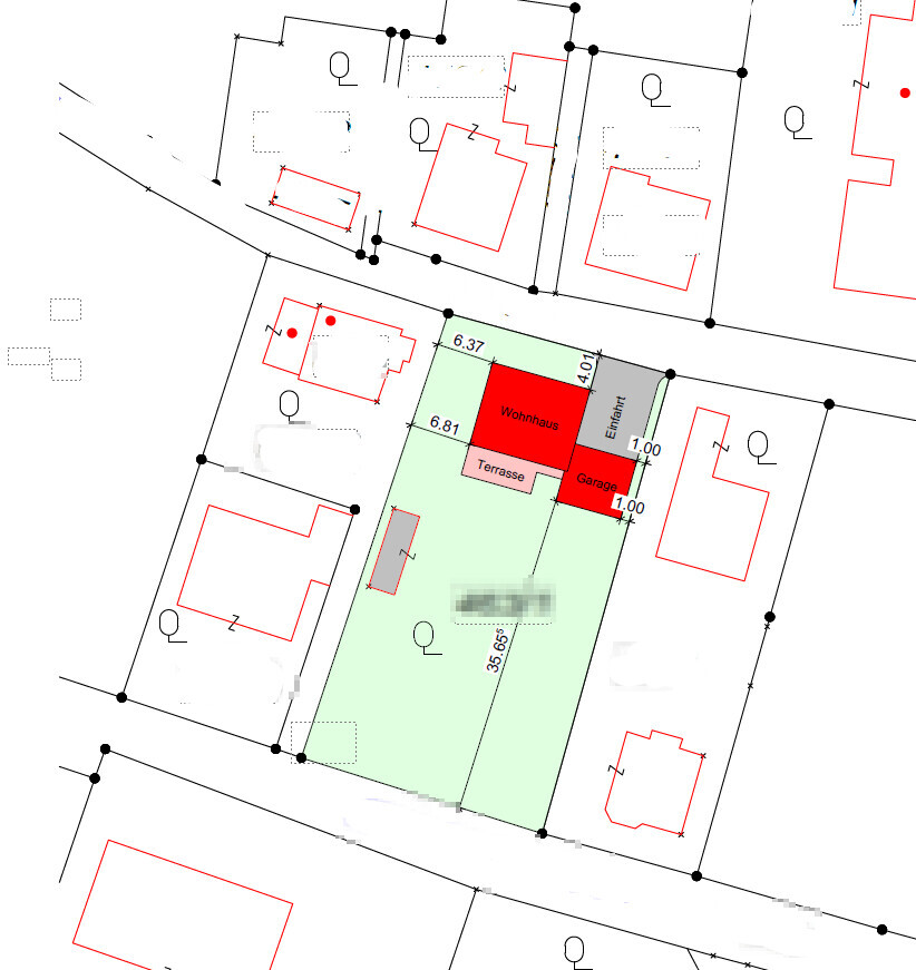

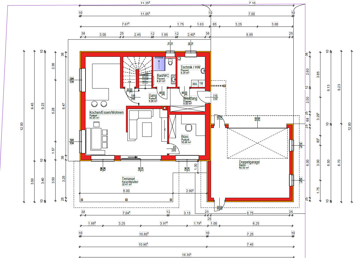

We are currently planning a single-family home on our plot and would like to get your opinions on the house placement and the floor plan. The house should have a maximum of 150 sqm (1,615 sq ft) of living space. The goal is to make it as cost-efficient as possible while still meeting all common modern standards. Basically, we would need about 10 sqm (108 sq ft) less space on the upper floor than on the ground floor, but extensions and complex roof constructions are expensive, so we have decided not to include them for now.
I have tried creating the initial design myself and have drafted the house positioning and the ground floor layout. The sketches are therefore very basic and contain drawing inaccuracies (non-practical dimensions, overlaps, etc.), so please bear with me. Windows, doors, and kitchen planning are not yet sufficiently detailed. The upper floor has not been drawn yet because our requirements can be met by various upper floor layouts from standard house types.
Regarding the positioning: Although the plot is large, it should remain divisible. The house will be located in the northern part (as close as possible to the northern street). The southern part of the plot will remain undeveloped and will be accessed from the southern street. A particularly important issue is privacy screening for the terrace from the neighbors to the east and west.

What do you like most? Why? Simple construction. Room program represented. Garage provides visual and sound protection to the neighboring house. Couch oriented parallel to windows; living areas oriented west/south. Garage located close to main entrance.
What do you dislike? Why? – long hallway. Stairs possibly extend too far into kitchen. Driveway is too long.

Why is the design as it is now? The garage positioning shows that the entrance should most likely be on the side —> side entrance leads to splitting the ground floor by a long hallway. Living areas are oriented as much as possible to the south and west.
Ground floor plan: kitchen, living/dining, office/guest, bathroom, technical/utility room, cloakroom, terrace, garage.

11ant18 Sep 2024 15:12
No, that’s not right!
Let him go ahead and gain his own experience. There’s no other way.
I am letting him, am I holding him back with my notorious enforcement squads?
I simply lack the sadism to let him walk straight into the knife of frustrating experience.
And above all: it is simply not productive. There are already upper floors that the OP likes; and they have ground floors that don’t convince him. So it makes more sense to work out where exactly his points of dissatisfaction lie.
I have not banned any way of thinking. I’m merely pointing out which effects to expect from a "bottom-up" development of floor plans (and that these effects are inherent to the system, not due to the planners being amateurs). The layperson-specific element lies only in the mindset that pays more attention to the preferred floor. An experienced or frustration-averse planner, on the other hand, works more efficiently by deriving the simpler-organized floor from the more complex one above. If someone wants, they can see this as a matter of personal taste in a free society. I’m just sharing my experience, transparently with the provided reasoning, so the informed future homeowner can understand it for themselves.

hanghaus2023
20 Sep 2024 13:48
hanghaus2023 schrieb:
A flat table and 10 degrees are definitely not the same.
I’ll bring up my comment again. You do realize that 10 degrees is quite significant, right? Is there a plan with elevation details so the slope can be seen? At 10 degrees, according to the rule from @11ant, it makes sense to have a basement. Otherwise, building only a lower ground floor (LGF) and ground floor (GF) might be an option, if that’s a suitable alternative.
I’ll bring up my comment again. You do realize that 10 degrees is quite significant, right? Is there a plan with elevation marks so the slope can be seen? At 10 degrees, according to @11ant’s general rule, a basement is justified. Otherwise, build only with a lower ground floor and main floor, if that is an option.
I assume you mean that the north-south axis is oriented roughly 35/17 degrees aeronautical heading, and the terrain is topographically flat.
Otherwise, a 10° slope over ten meters (about one hundred feet) corresponds to nearly 1.8 meters (6 feet) difference in height, which translates to roughly 90% of basement construction costs, yes.

We have now received the first draft from the planner. In the ground floor (GF), my initial draft was adopted almost 1:1, although this was not even requested. From our perspective, the following changes should now be made:
GF:
- The fireplace will be relocated to the corner of the load-bearing wall between the kitchen and dining area.
- A fixed (fireplace) stove with a width of 40-50cm (16-20 inches) is planned, so that it acts as a room divider between the dining area and living room instead of the wall. The length is still unclear, maybe 150cm (59 inches)?
- Orientation of the couch and TV reversed. The couch is placed against the wall of the office/guest room and the TV is mounted on the fireplace.
- Possibly an additional narrow window on the north side of the kitchen, near the corner of the house.
- Reduce hallway width by 10-15cm (4-6 inches) away from the coat storage area (currently 140cm (55 inches)).
- Reduce the width of the WC/bathroom, for example by letting the shower niche extend into the utility room at the back. Width near the door only 1.2m (47 inches)?
- Kitchen: Width along the north side should be 3.1m (10 feet 2 inches) instead of 3m (9 feet 10 inches) to allow for a 65cm (26 inch) corner cupboard and otherwise exclusively 60cm (24 inch) cabinets.
- Kitchen: Unclear if there is a bottleneck between the hall corner and the "bar".
- Utility room: Unclear if it is too small.
