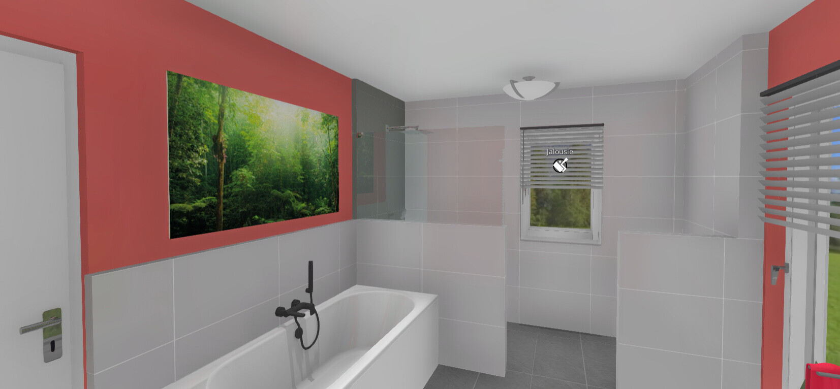

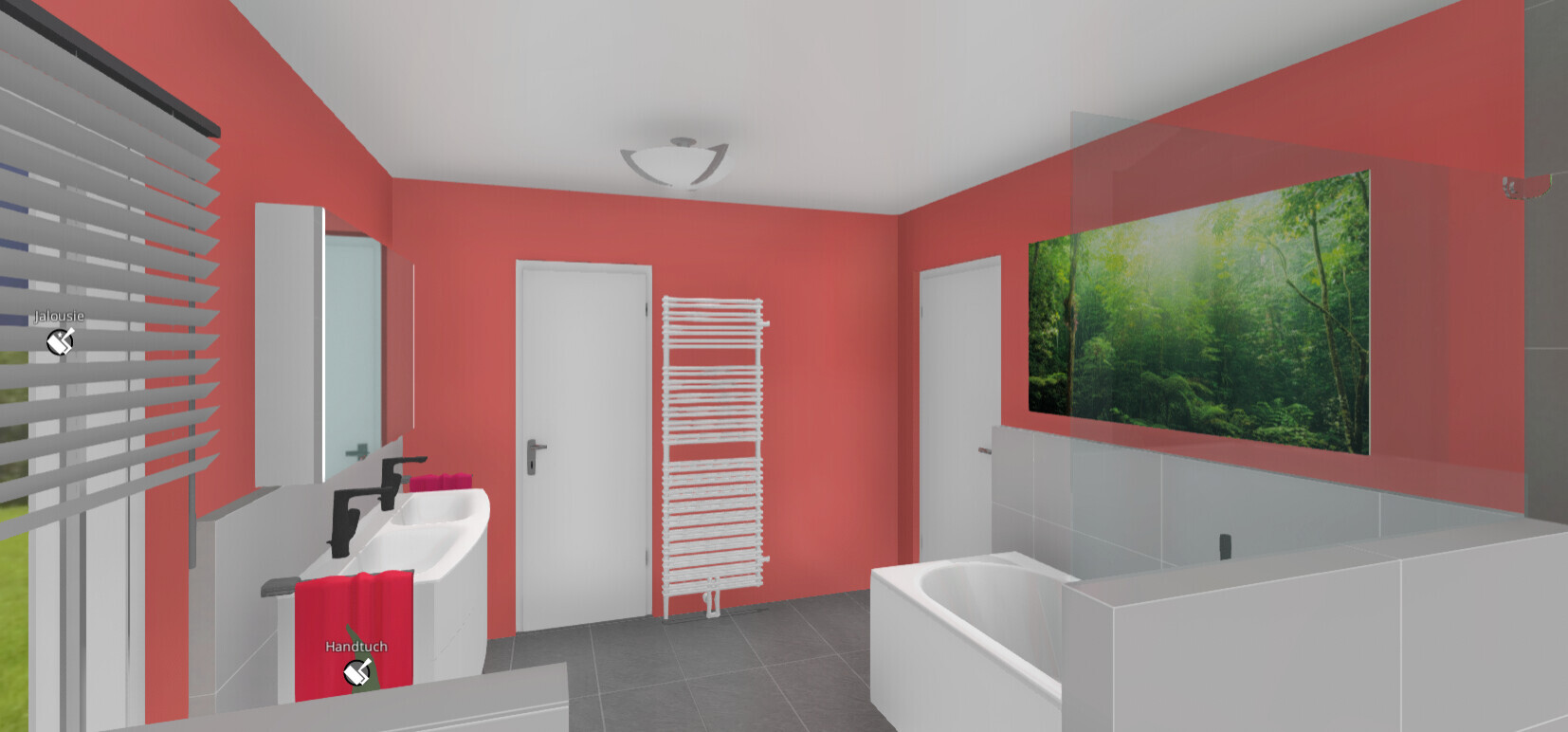

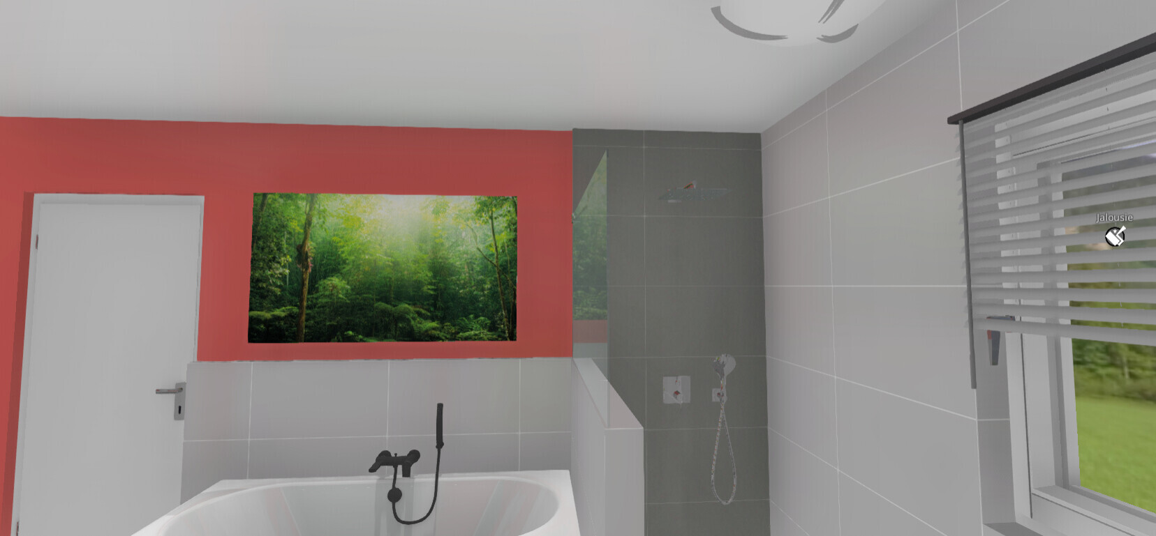

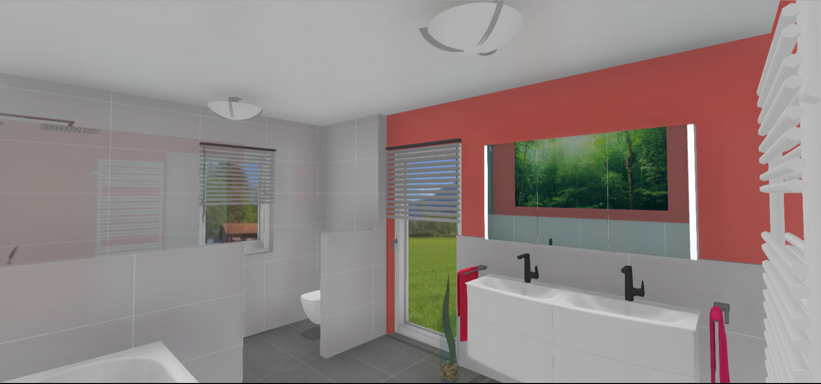

hanghaus20234 Nov 2024 11:10hanghaus2023 schrieb:
In my opinion, the laundry chute is unnecessary, I had written "WAS" in capital letters, which was meant to stand for laundry chute.
I will clarify the matter with the downspouts with the planner.
The laundry chute will probably be removed.
I really like the bathroom layout and the extension of the storage room to a utility room on the upper floor, thank you very much @hanghaus2023! With a bit of refinement, I can well imagine us implementing it this way!
