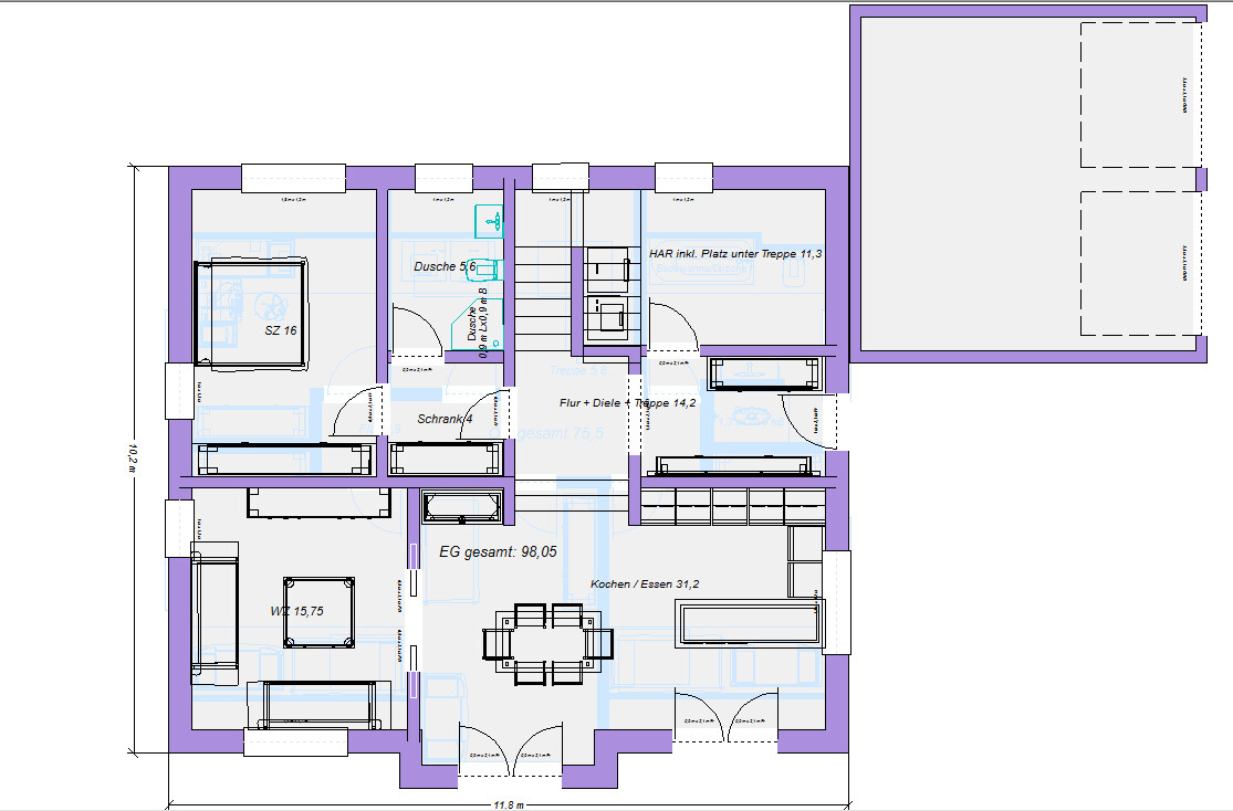

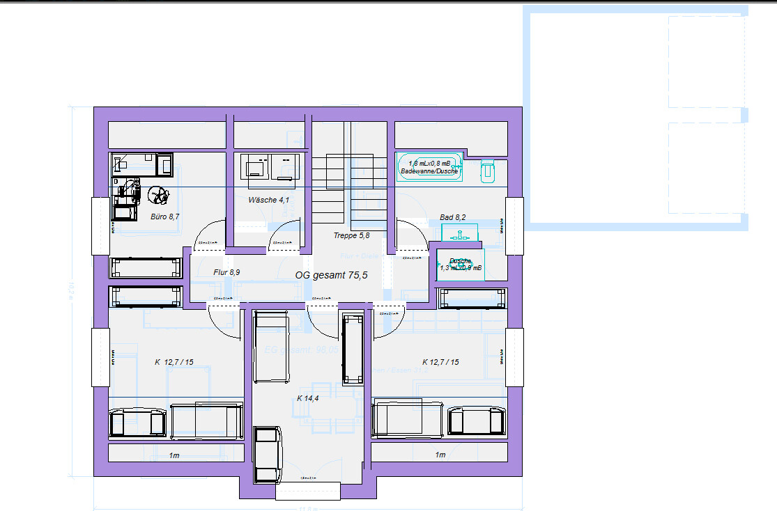

The 1.5-story house reduced to 173.5 sqm (1867 sq ft):
Hardly noticeable. An experienced draftsman could probably get it down to 170 sqm (1830 sq ft). Based on a rough estimate of 170 x 3000 per sqm, the cost would be around 510K—though this excludes landscaping and extras. Whether the captain’s gable is included in that price—hmm, hard to say. And then there’s the split foundation slab. Yeah, that’s quite tight.
I would rotate the kitchen counter. It adds overall value to the kitchen. Personally, I would also remove a few short wall sections.
Anyway, you can see where it could be going.
The question is where your break point is in terms of the split (stairs). I’ll probably skip that here 😉
K a t j a schrieb:
The 1.5 version reduced to 173.5 sqm (1868 sq ft):
[ATTACH alt="EG.jpg"]75676[/ATTACH]
[ATTACH alt="DG.jpg"]75675[/ATTACH] Katja, thanks again for your efforts! 🙂 We already have a general contractor (GC) with whom we are quite satisfied so far. Even though we discarded the initial designs, these seem to have more substance than our own bungalow draft. The GC builds using a timber frame method with 33.5 cm (13 inches) exterior walls and 13 cm (5 inches) interior walls. This could also save a few centimeters on the external dimensions.
The neighbor from post #49 apparently got approval for increasing the knee wall height from 50 to 80 cm (20 to 31 inches). This could also be used to save a few square meters (square feet).
K a t j a schrieb:
At a rough estimate of 170 x 3,000 per sqm (1868 x 279 per sq ft), we would be at 510K – but that’s without landscaping and extras. Whether the captain’s gable is included in the price – mmmh, hard to say. And then there’s the divided slab foundation. Well, that’s a tight budget. At that time, the price per square meter was even around €3,200 – and that was before the economic upheavals…

One last question about Katja’s floor plan:
Is there any reason not to switch the office and laundry room with the bedroom?
Frennie schrieb:
Is there any reason not to swap the office + laundry room with the bedroom? Yes, the room layout. Combining the utility room and office makes it impossible to furnish them together with a double bed and a wardrobe for the family.
