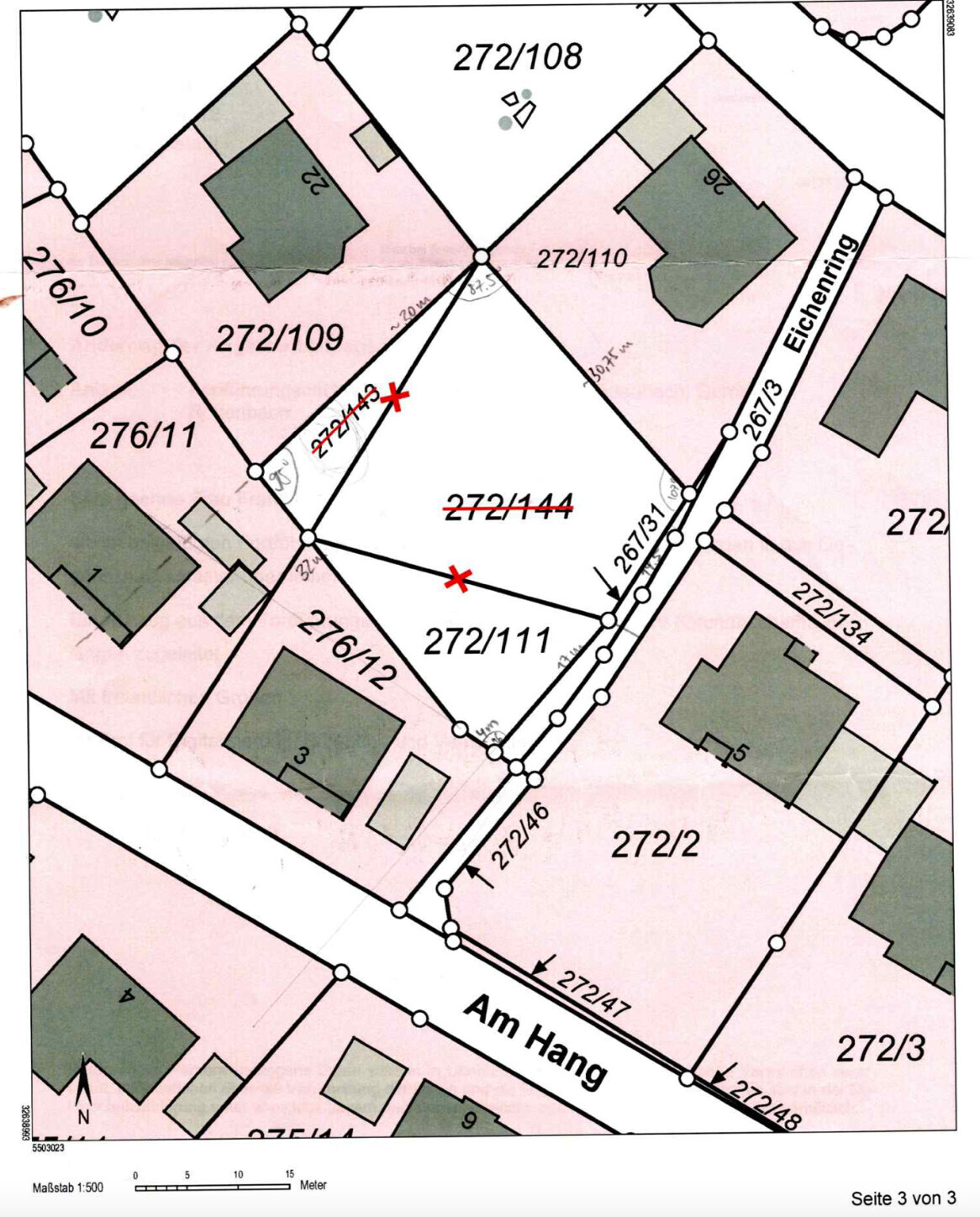

Is there a site plan with elevation points? Of course, that’s also an important issue! There is no site plan. According to Bayernatlas, the north-south slope over the area where the house is finally supposed to stand is 1.20 m (4 ft). Naively, I had thought this wouldn’t have a significant impact and might be manageable with earthworks.

Please show the size and access to the plot on the cadastral map, as it’s not clearly visible on the aerial photo. It seems you are planning the rooms and their layout on the floor plan somewhat differently than the images of the design examples suggest. Try planning more conceptually rather than specifically, so intention and successful results might align better. Due to the apparent omission of a hallway, the kitchen is basically located in the middle of the actual entrance area. Please share the floor plans of the discarded design stages. There isn’t a real development of the floor plan for the bungalow since the latest plans were still for the two-story single-family house.
