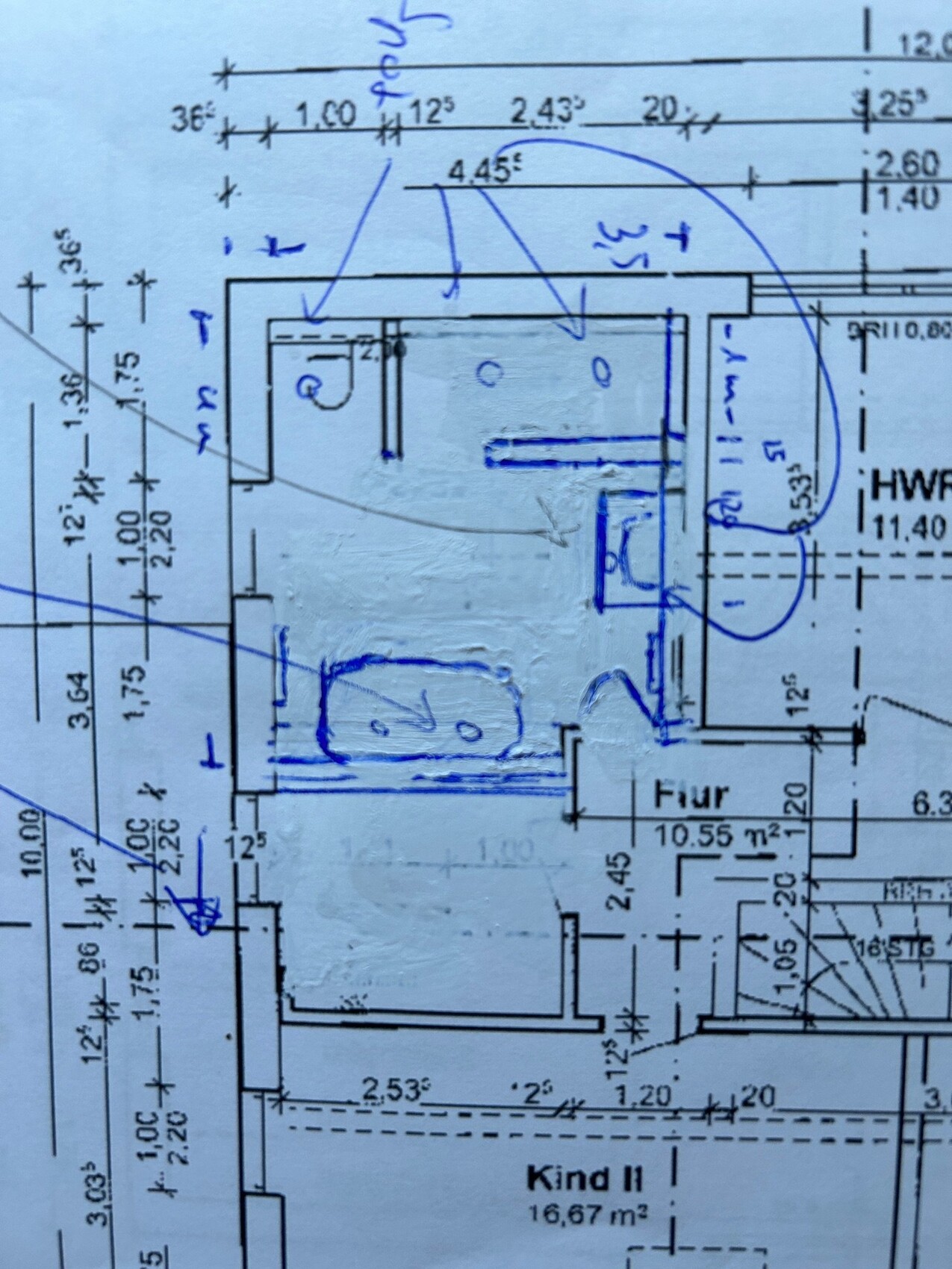

- UF: Bathroom → moved storage room (including washer and dryer) to make it larger and separate from the bathroom – see hand drawing:
- Walk-in shower with fixed glass panel
- Toilet separated from shower by a half-height drywall partition
- Half freestanding bathtub

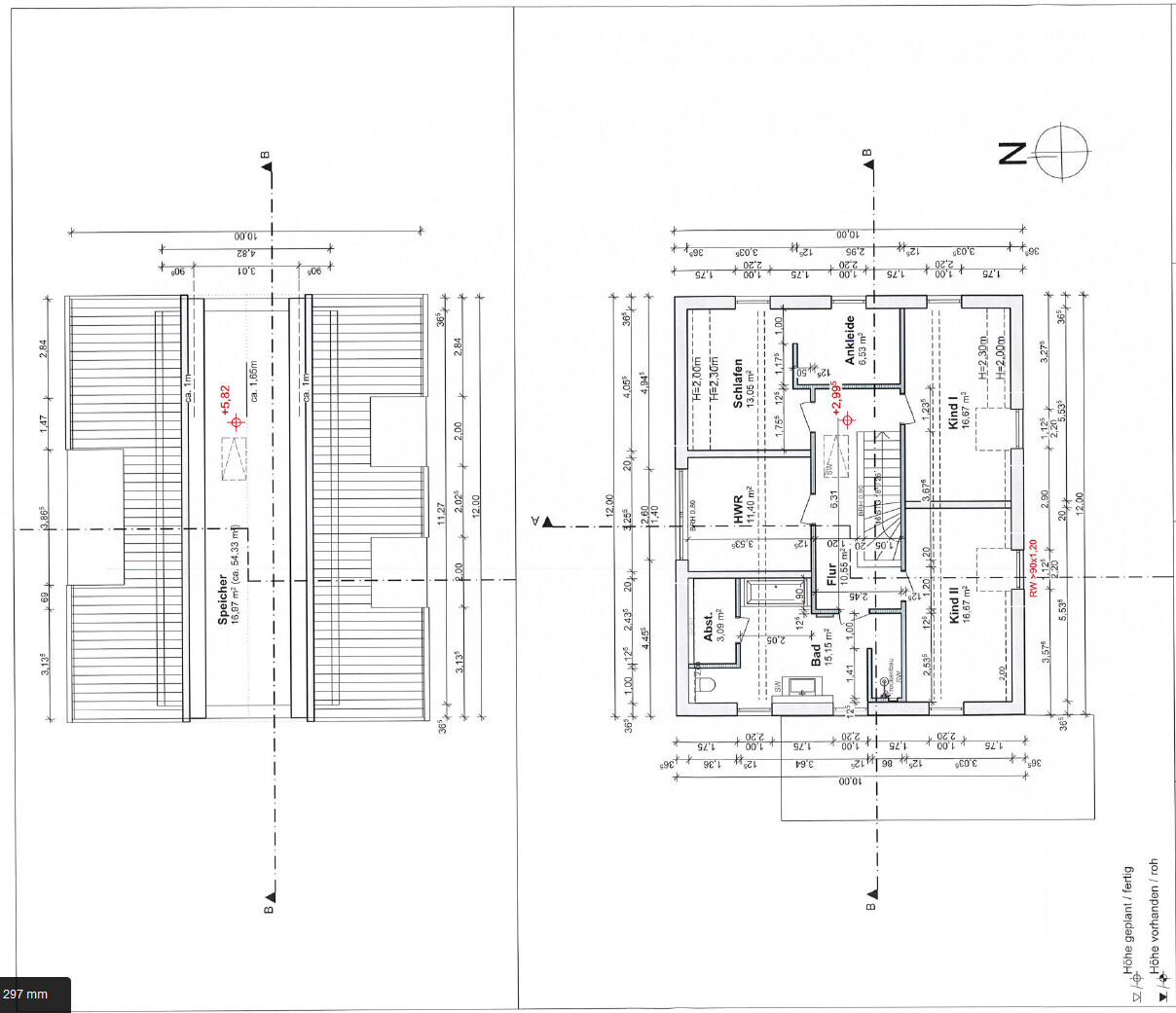

- Should we open the upper floor hallway towards the roof and insert a narrow skylight strip on the north side (max. 50 cm (20 inches) height)? South side not possible due to photovoltaic panels.
- Advantages:
- Natural light in the hallway
- More spacious (visually)
- Disadvantages:
- Custom solution / additional costs
- Not very practical: summer heat? Loft storage space lost, difficult to paint/clean windows…
- Alternative would be a window above the door to the storage room
- Hallway on ground floor: We had to really squeeze by the stairs. How does the staircase entrance appear? We tend to remove the window element to the living room, as the hallway will likely be bright enough, this allows more flexible living room arrangements (furniture/pictures), and the staircase entrance will look better visually. Any other ideas for changes?
- Bathroom upstairs: After the changes (see hand drawing), any further optimization ideas – e.g., shifting the storage room window slightly (10-20 cm (4-8 inches)) south to create a deeper bathtub niche?

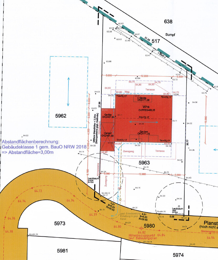

- Waterbody buffer zone: The plot will be filled up to street level up to the waterbody buffer zone. The buffer zone itself must not be filled. We would like to build a 1 m (3 ft) high natural stone wall here. Unfortunately, the buffer zone stretches right to the building envelope. Any ideas on how to solve this?
- Tool shed behind carport: steel + wood cladding with paved floor, or solid masonry with brick facing and foundation? Advantages and disadvantages? Visual impact?
- Width of the path from driveway to main entrance: Currently, the path from carport/driveway to the entrance seems unnecessarily wide. What would be a generous but sensible width?

Is that really the case? Do you want to use the small bathroom near the entrance as yours? Before settling for something like that in old age, most people get tired of gardening and end up moving to an apartment in the city.
And that’s exactly what I see as a real drawback. You basically have only a narrow, hidden path leading to the open living area. Even before the change, there is a door to the living room hidden there, which doesn’t look very inviting. Entering the kitchen through a narrow corridor carrying groceries wouldn’t be my choice.
By the way: I would give the kitchen 30cm (12 inches) more depth and then plan a proper island, not just a small extension.
To be honest, since I read that, the design is giving me a headache. You need the utility room, you need storage space, you need a place for laundry. The guest bathroom is too small. (By the way, swap the guest bathroom and the utility room.)
Whether the bathtub is flush or deeper won’t matter once you move in.

Bathroom upstairs: Are there further optimization possibilities after the change (see manual drawing)—for example, the idea to move the window in the storage room slightly (10–20cm (4–8 inches)) south so that the bathtub niche becomes a bit deeper?

Additionally: The new door to the office on the ground floor is drawn too narrow. Why? Because otherwise it wouldn’t fit into the floor plan...
Otherwise, you would also have to move the wall to the living room.
Why are you planning to live on the ground floor? Nobody does that anyway; either you have a stairlift or you curse the huge house and its costs and move to the city into an accessible apartment, possibly with an elevator.
Are you aware that when entering the bedroom, you will stumble straight into the bed?
With a 200cm (79 inches) wide bed plus two 40cm (16 inches) bedside tables, the door just barely opens, but the clearance is very narrow. Try furnishing it, then you will see.
What is the purpose of the walk-in closet, other than creating more circulation space? The purpose of a walk-in closet can either be to hide the wardrobe from view from the bed (pure aesthetics), to create a generous “getting ready” area, or to avoid waking your partner while dressing because you can exit to the hallway through the closet. Two of these options don’t apply in your case...
In short: forget about prioritizing the appearance, and all issues will be resolved.
John333 schrieb:I have marked the mistake by underlining it.

Perhaps it should be mentioned again that the staircase placement is crucial. It influences the entire floor plan. It is often unfortunate when the staircase runs along the ridge beam or opposite the entrance. In these cases, it blocks the hallway leading to the open-plan living area. Both accesses are hidden and make the house feel unwelcoming – there are no important sightlines, and the upstairs corridor is dark. I did not understand the question/suggestion about the window.
