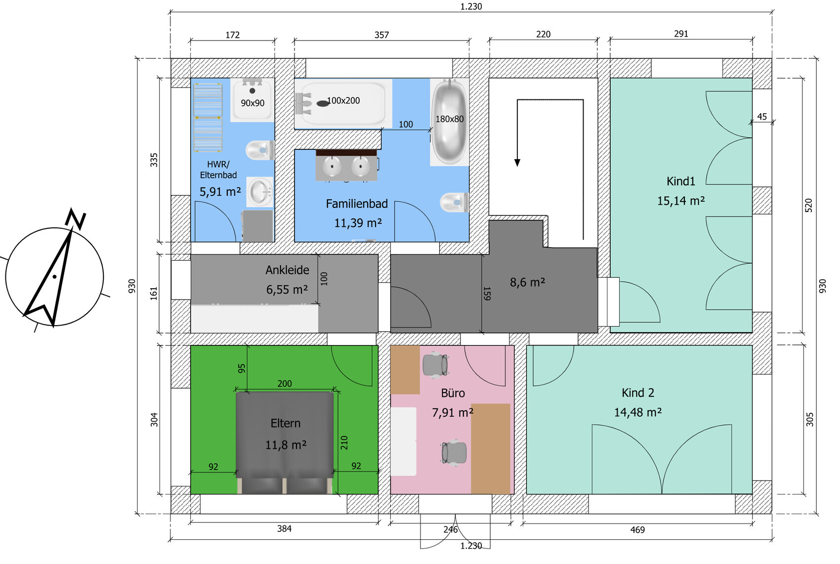

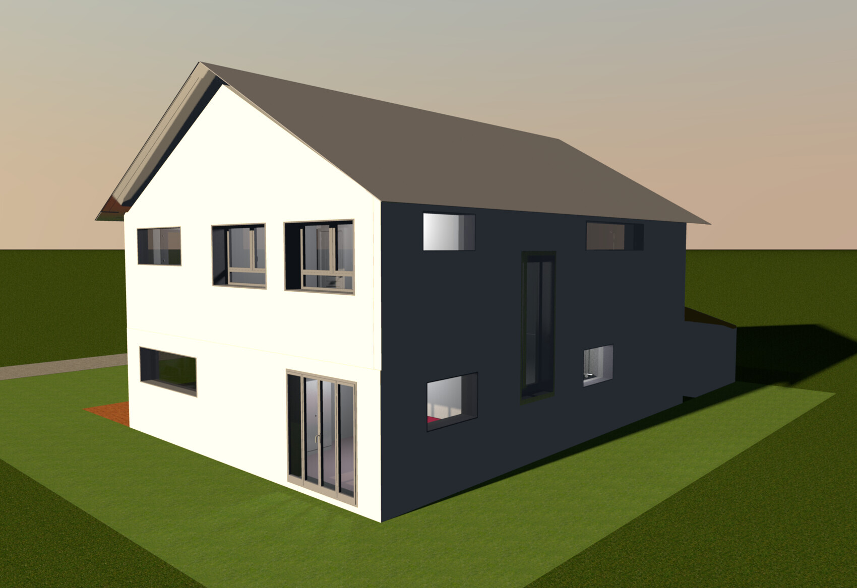

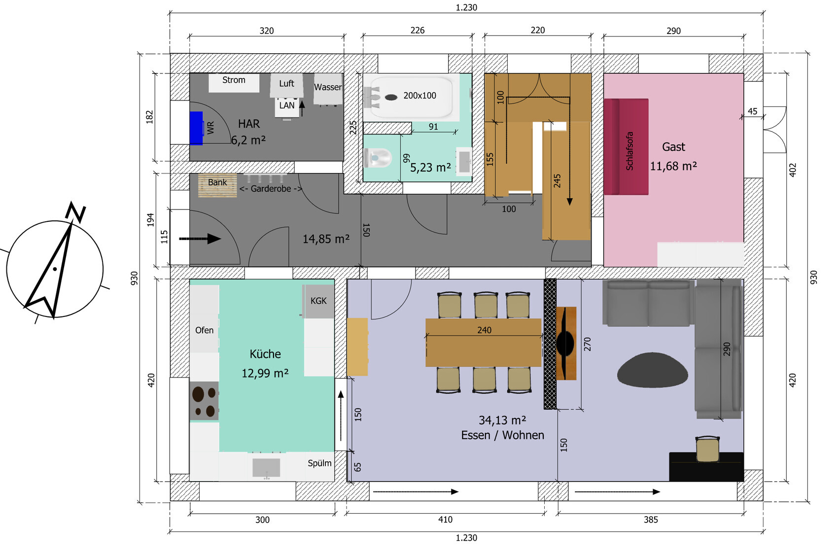

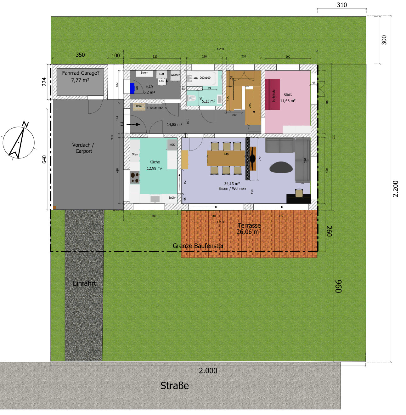

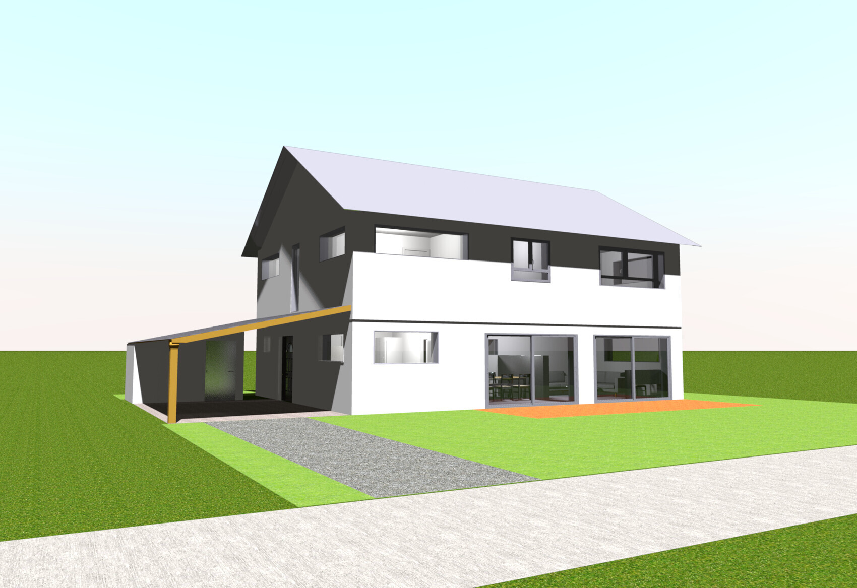

DerPaddyHello dear forum community,
I am finally moving from being a silent reader to asking for help (and of course, pressing "Enter" way too early).

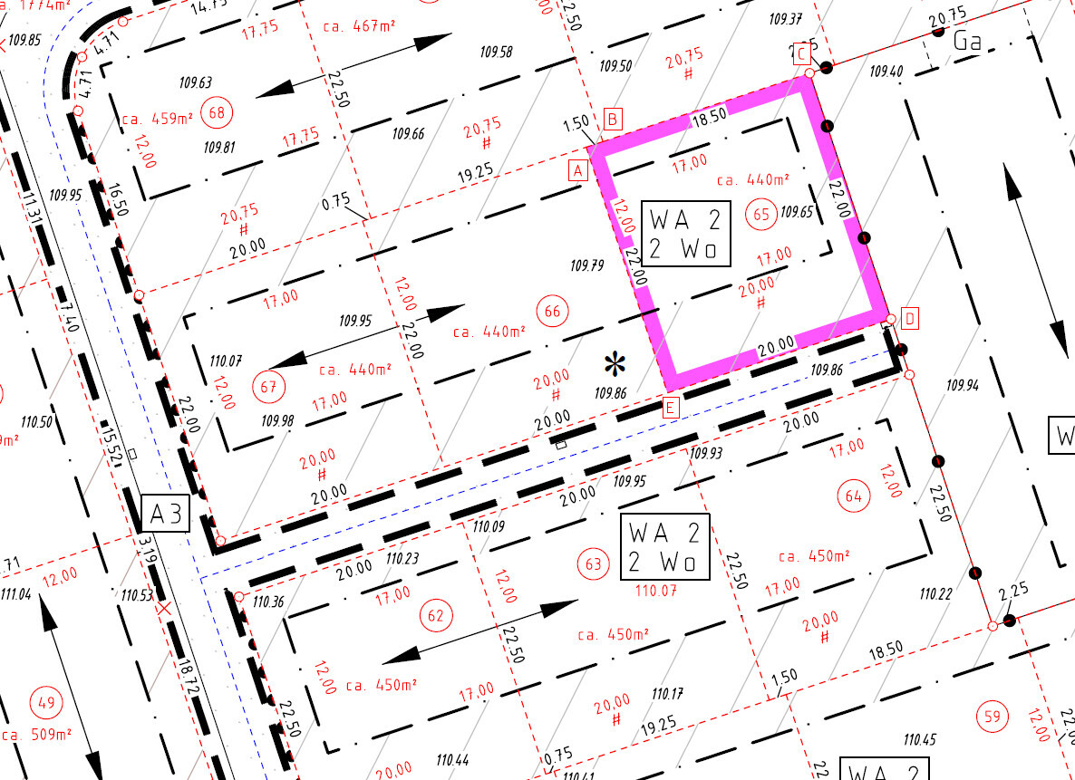

Our plot is located in a new development area, surrounded by detached houses and semi-detached houses. To the east, however, there is also a row house block.
My most practical design, based on orientation and the building plot constraints, assumes a west-facing entrance but without a large garage. A basement is not planned at the moment (my partner is not a fan of basements).
I’m curious to hear your thoughts. Maybe it’s a complete mess.
Outdoor areas, carport, and windows were not planned in much detail yet. As for the porch and shed, I’m not sure what is feasible or sensible. So the main focus is on the interior.
But I’m also happy to receive tips for outdoors!
Thanks in advance!

Upper floor:
Bedrooms isolated, even children’s room not adjacent to a bathroom –
Utility room upstairs (short distances) + can be upgraded to a master bathroom (once teenagers are at home)
Ground floor:
Guest shower room instead of just a toilet (also for family)
Guest room can serve as a bedroom in old age
Kitchen and living are separated (noise and smell protection), if possible with sliding doors partially openable
Closed hallway – less noise disturbance

Ground floor:
Hardly any cloakroom, large hallway due to closed layout
No pantry
Little storage space in the utility room
Entrance from the west, which saves garden space

- Lady of the house is quite sensitive to noise, so a rather closed layout with a separate bedroom planned
- Already somewhat barrier-free: Wide doors, preferably walk-in showers and step-free transitions
Designer: So far completely do-it-yourself
What is liked most:
Upper floor:
Ground floor:
What is disliked?
Ground floor:
No pantry

DerPaddy schrieb:
In the east, but also from a row house block.
My most practical design, considering orientation and the building plot, assumes a west-facing entrance but without a large garage. Why?
If a carport/garage built on the property boundary is allowed (I assume it is despite the building plot), I also see the entrance here (garden turned away from the row houses).
You should be able to find a functional and attractive house design online for this situation.
Personally, I would position the house differently, with the gable end facing north-south, and the garden and terrace on the west side.
Children’s rooms either in the south or west, the office as a secondary space, bathroom sinks placed by windows, showers not by windows.
You don’t need a separate room for a 2-meter (6.5-foot) wardrobe.
If building a carport or garage on the property boundary is allowed...
Gable facing north-south, garden and terrace on the west...
For a 2-meter (6.5 feet) wardrobe length, you don’t need a separate room... Unfortunately, the development plan restricts parking spaces, garages, and carports specifically to buildable areas.
Also, the main ridge orientation is fixed in the plan, so there isn’t much flexibility to rotate or adjust the layout.
Access and driveway on the east side is possible (for example, if you mirror the design horizontally), but that would reduce a lot of garden space.
But you are right—having the garden on the west and south would be much better. Let’s see if I can manage that.
Regarding the wardrobe length: that’s true, but here the walk-in closet is more of a sound buffer and passage room rather than a functional dressing room.
I will take another look at the bathrooms, thanks!
