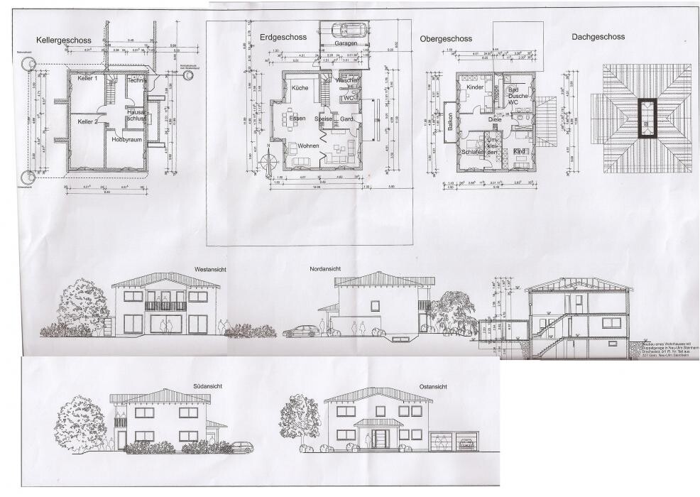

We have been planning to build a single-family house for a long time and have now finalized the attached floor plan.
What do you think about it?
Our priorities were:
- 2 full stories
- Access from the garage to the main house
- Combined dining and kitchen area
- Living area can be separated by a sliding door
We would appreciate any suggestions for improvements or practical advice!
Thank you very much for your feedback!
- 2 full stories
huettenwirt12 Jan 2014 19:27Wanderdüne schrieb:
Focusing solely on a floor plan is the wrong approach. It’s always about a design, meaning the combination of the client’s wishes, the requirements and possibilities of the plot and its surroundings, as well as legal and other framework conditions.
Do you already have a plot?
WDYes, the plot is already available. Since it is somewhat secluded, there is no zoning plan / building permit requirement.
This means we have the freedom to be creative from this aspect.
Wanderdüne12 Jan 2014 22:03When you own your own plot of land, fortunately you have all options available.
Therefore, write down your own requirements, find architects whose references match, evaluate collaboration, sign a step-by-step contract, and keep us updated.
Also read all design discussions to be able to assess the designs.
WD
WD
If there is no local development plan, it does not mean you can build however you want! In that case, §34A of the Building Code applies. This means you are allowed to build in a way that matches your neighbors. If there are single-story plus attic houses, you probably cannot build two full floors. If only pitched roofs are common in the area, a modern flat-roofed villa is likely to be rejected — ultimately, it depends on the decision of the planning committee.
If your plot is secluded and located outside the built-up area (known as the outer area), it could be problematic anyway. Have you spoken to the responsible authority about what they might consider acceptable?
