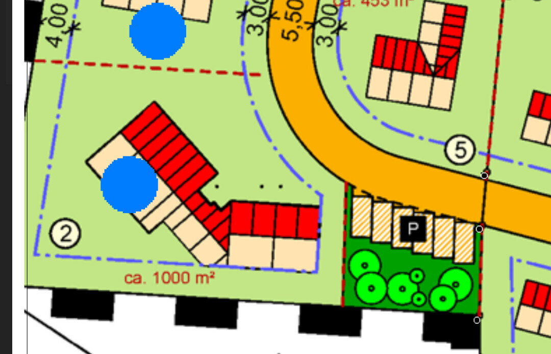

Here is the site plan… The north arrow is located on the floor plan document.
