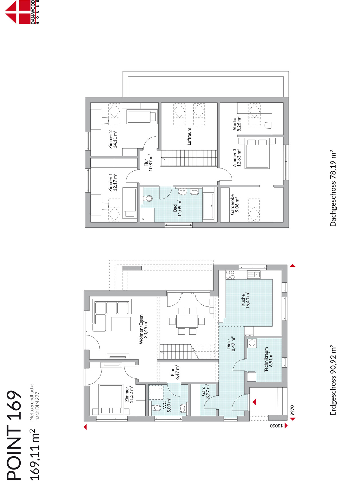

Who designed the plan: Drawing by the construction company, design by me
What do you particularly like? Why? Large windows, walk-in closet, bathroom, semi-enclosed living room, small gallery above the staircase
Open Issues:
Currently, the house is set back 3m (10 ft) from the street (this affects kitchen and guest room). Is this sufficient? Or should we increase it? That would make the garden smaller.
Lighting plan, but this might not be the right place to discuss it in the forum.
We are unsure where to place recessed or surface-mounted spotlights, wall lights, in which rooms, and how many outlets are needed.
I think the staircase is drawn slightly too small in the plan. I need to discuss this with the architect again.
Is the utility room large enough? How much space does the gas heating system take?
On the upper floor, next to the staircase at the back, we want to create a small storage room by adding a partition wall and move the skylight above the staircase. However, this would likely be only 1.5 - 2 sqm (16 - 22 sq ft). Is that worthwhile?
We would appreciate any feedback on our floor plan as well as new ideas.

So, don’t we have two streets? I thought on the left side of the plan (south) there is a main road, and at the bottom of the plan the access road to the residential area or something similar. The original poster lives right on the corner, correct? Or is this Michaelis Street to the south?
Michaelisstraße (new) is located in the south. To the west, between Kräßmannstraße (coming from the north in the old residential area) and the property, there are public parking spaces along with green strips, as I see it. The access road likely runs east-west to the south, i.e., "below" the new residential area, parallel to Michaelisstraße.
kaho674 schrieb:
Danwood 169 could also be an option. However, it is a bit larger. Move the entrance downwards according to the plan and close off the corner to create a larger utility room. The open space can probably be redesigned as well if someone doesn’t like it. Additionally, add extra windows in the kitchen.
Setting the thread aside, this is once again a nice Danwood floor plan.
I’m not familiar with their larger models. Maybe I should browse their website again sometime [emoji2]
Apart from the thread, this is once again a nice Danwood floor plan.
I don’t really know their larger models. I should take another look around their website sometime [emoji2] However, I think they drew the staircase in the ground floor reversed. It’s always worth browsing Danwood’s offerings for home builders. 🙂
