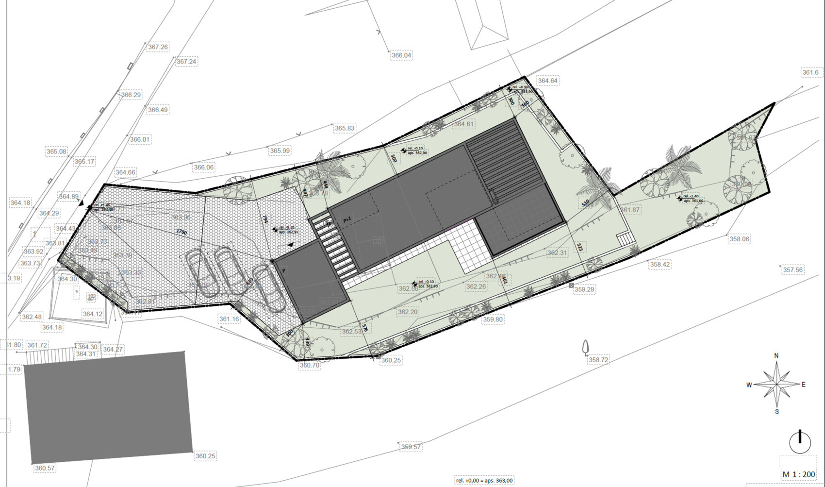

Ground floor:
Upper floor:
[ATTACH type="full" width="500px" alt="Two-dimensional house floor plan with bedroom, bathroom, kitchen, and terrace">
3D view:
3D model of a modern hillside house with flat roofline, large windows, and terrace
Plot plan with house, terrace, garden, and driveways

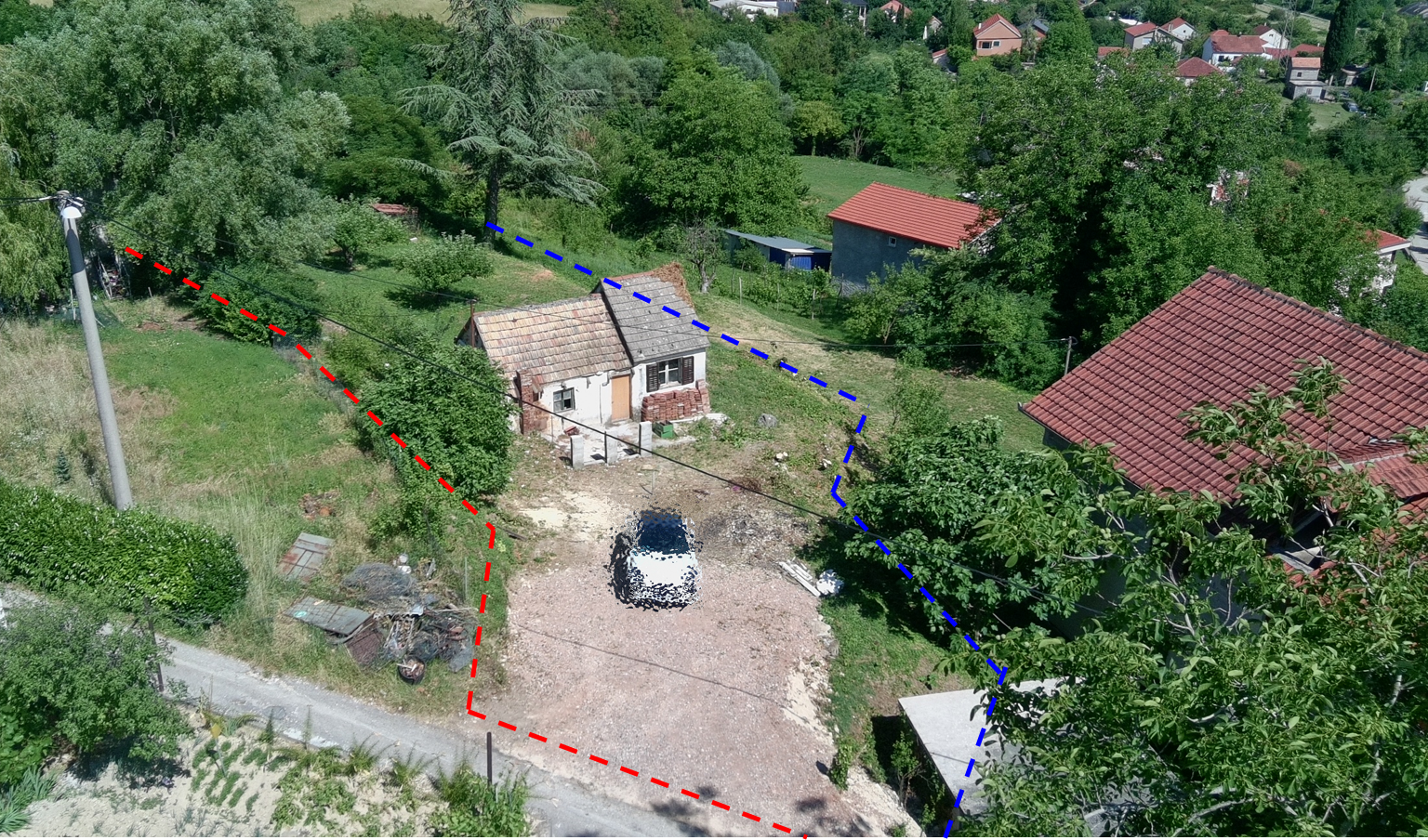

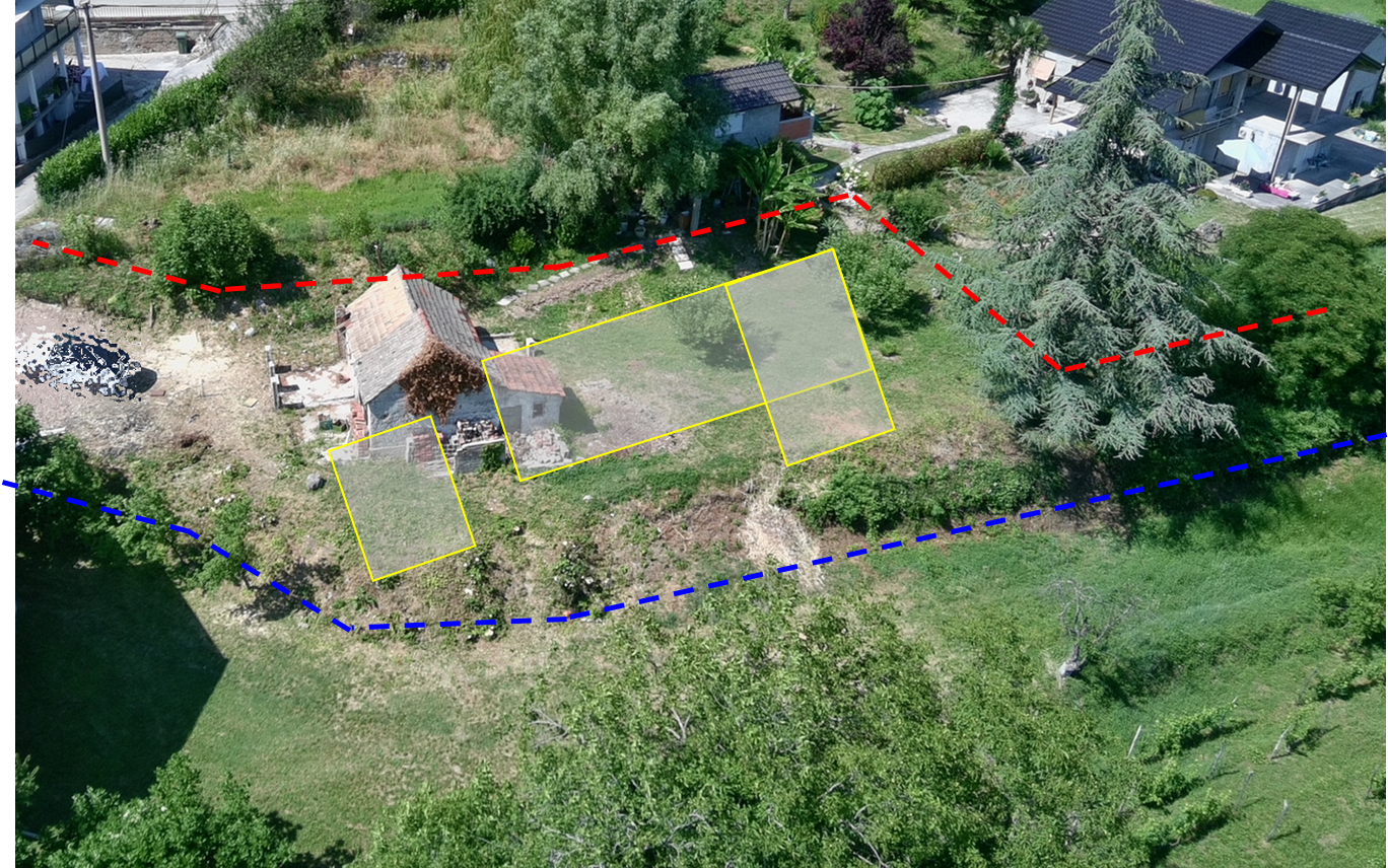

hanghaus2023 schrieb:
What is located below there? Is there an aerial photo of the surroundings?
Here are two aerial photos: one taken from the driveway side (sloping downhill, you can see what’s below).
And a second aerial image showing the sketched property boundaries and an approximate indication of where the house is planned:

We wanted the concept to include the option for a garage.
The architect tried to make the best use of the plot (his statement). Unfortunately, we have to keep a 3-meter (10 feet) distance from the property boundary on all sides. That makes positioning difficult on this rather narrow and long plot.
The driveway is challenging; so far the architect did not want to rotate the garage. He said there is enough space for the driveway and it fits better if the garage is aligned as closely as possible with the house.
It’s also true that the area towards the driveway side is not very attractive / there is no nice view, so by positioning the garage there we partially shield ourselves and gain some privacy.
The garage is not really small; currently planned interior dimensions are 4.50 m x 6.10 m (15 feet x 20 feet).
The goal is to park one car inside the garage. The other three required parking spaces are planned outside.

That bulky block with the small garage at the entrance and the cars parked all over the place would be my first deal-breaker at least.
You mean the house when you say “bulky block”?
I currently have no good idea how to optimize it sensibly. Expanding the garage is not an option; at 25 sqm (270 sqft) we consider it large enough.
Do you have any ideas?

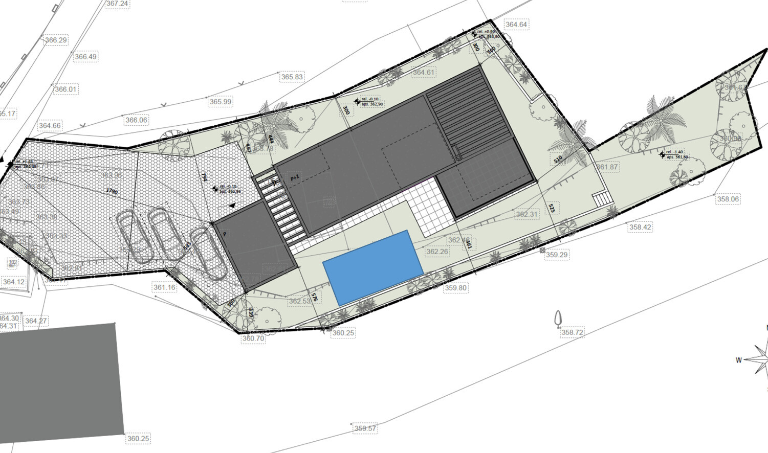

I’m also missing a proper pool. Apparently, this is a holiday home in the countryside, not by the sea. If I consider my expectations, which aren’t very high, I would expect a pool at such a house, especially if it were mine, for a proper summer vacation.
We haven’t actively included a pool in the current plan.
It is a holiday home in the countryside (25 minutes from the sea), correct.
There is provision for a pool; here is a sketch with the potentially planned location:
Site plan of a property with building area, terrace, garden and pool

ManuelB schrieb:
The access with the garage between driveway and house is not very nice, I agree with you on that.
In my opinion, such a beautiful house project should also have an inviting entrance area; I would rather envision something wider with a nice entrance gate, trees or shrubs, natural materials... and behind that maybe not such a (sorry for the expression) “flashy” building, but something smaller or more in scale with the plot, focusing much more on outdoor living, and definitely a pool right away (especially since it’s a 24-minute drive anyway). You or your staff will also have to maintain and clean the house... that’s a very important point!
We rented a nice lakeside house in South America for a long time that had been empty for several weeks before, and it was so dusty and full of spiders and other things. Your house will be beautifully located in nature and you won’t be there very often. Managing it won’t be a minor task, not just because of dust but for other reasons as well, unless you want to organize a major cleaning session every time you visit. I mean, without staff on site, I would definitely want to build a holiday home smaller and easier to maintain.
ManuelB schrieb:
The architect tried to make the best possible use of the plot (his statement).
... more like maximizing use, but for me here quality would definitely beat quantity. That intention wouldn’t be my approach.
ManuelB schrieb:
Unfortunately, we have to maintain a 3-meter (10 feet) setback from the plot boundary on all sides. That makes the positioning on the rather narrow and long plot more difficult.
Maybe two building wings could be an option — main house plus guest or ancillary house — which could also offer advantages for future use (older children, etc.) and provide more privacy and flexibility.
ManuelB schrieb:
The garage is not small, currently planned inside: 4.50 m x 6.10 m (15 feet x 20 feet).
A garage would be very low on my priority list and would have no defining effect or disadvantage for my house unless, of course, you have a million-dollar classic car or something like that. Otherwise, why not go for an open carport that is architecturally lighter and easier to integrate visually?
ManuelB schrieb:
We initially started without the desire for a roof terrace or balcony on the upper floor.
These can be expensive and require additional upkeep. For me, a really small porch or balcony would be the maximum. Instead, the ground floor could be more generous for everyone, since that’s where we especially want to enjoy time together... by the pool, on one of the terraces, or in seating areas.
ManuelB schrieb:
You mean the house with the “bulky block”?
I currently lack an idea on how to optimize it sensibly. Enlarging the garage is not an option; with 25 square meters (270 square feet) we think it’s big enough.
The look of the house starts with that crosswise garage wing, and I wouldn’t want it like that. I’d simply wish for a smooth driveway area. Unfortunately, I can only criticize and not draw, but maybe the garage (if it really has to be there) could be placed uphill, above or behind the house. I would leave it out completely and spend the money on many beautiful things, first and foremost a top-quality pool. I just got back from friends in Spain, also a holiday house as a residence but with a pool (and they live only 8 minutes from the beach).

ManuelB schrieb:
We have not actively included a pool in the planning so far.
Never...
