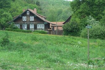

Just a question here: Does a forest (edge) villa exist? 😀

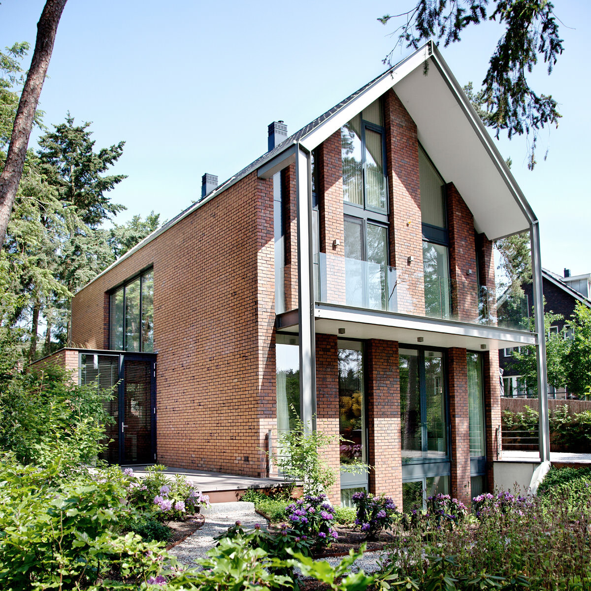

In classic style
Traditional wooden house in a green forest landscape with meadow.
And in modern style
Modern brick house with large windows, balcony, and garden.

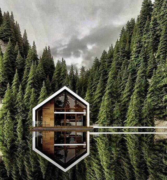

Preferably by a lake ;-)
Modern pentagonal wooden cabin with glass fronts, surrounded by dense forest, built over water.
