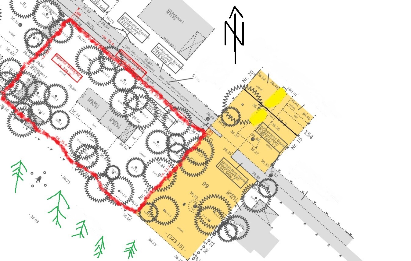

Your information is just guessing. 🤨
Is it not possible to get a plan that clearly highlights the plot and specifies the access? What kind of building encumbrances are those?
Lycana9 schrieb:I thought it was the plot? :p
The yellow area is the public road
Lycana9 schrieb:
The yellow area represents the public road And are there trees scattered all over the street? If you want help and advice here, you should provide a bit more information.
Regarding the layout, I simply don’t understand why in so many floor plans the sofa is always positioned with its back to the garden. Do so many people really want to sit on the sofa facing a blank wall? Especially nowadays, with flat-screen TVs that can be mounted on any wall or projectors with screens, the traditional wall units with TV space are becoming quite obsolete.
