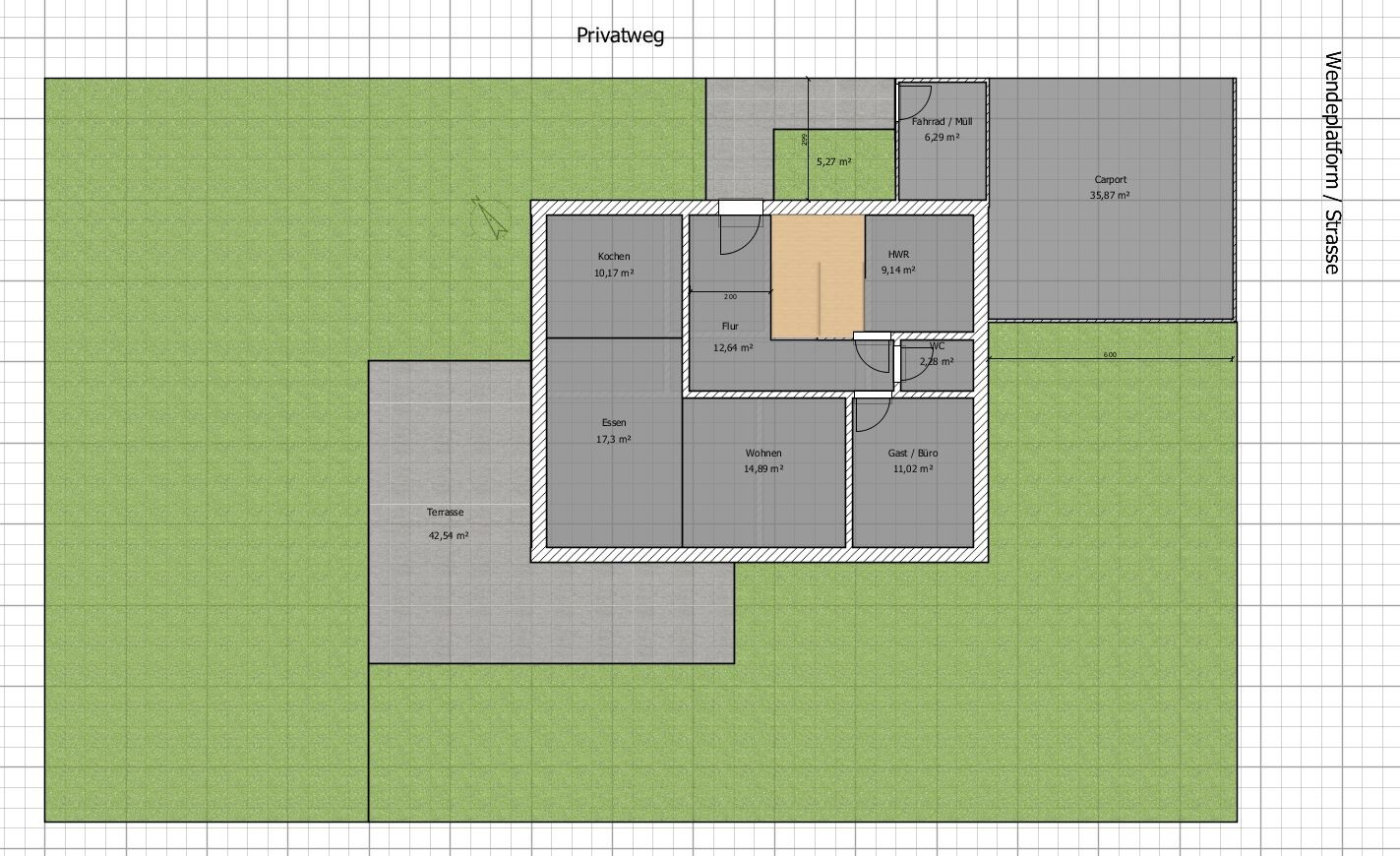

The forest is a designated protected landscape area in private ownership. Future development is therefore almost entirely ruled out. The lease agreements next to us were just extended by 5 years. In the long term, we understand that the leased plots will also be converted into single-family homes.
This is roughly how I would arrange the house on the plot:
(Approx. 160m2 (1,722 sq ft), but actually the same room layout as yours.)

The plot is located in the southeast, directly adjacent to the forest edge Am I seeing things wrong, or is the forest actually to the southwest?

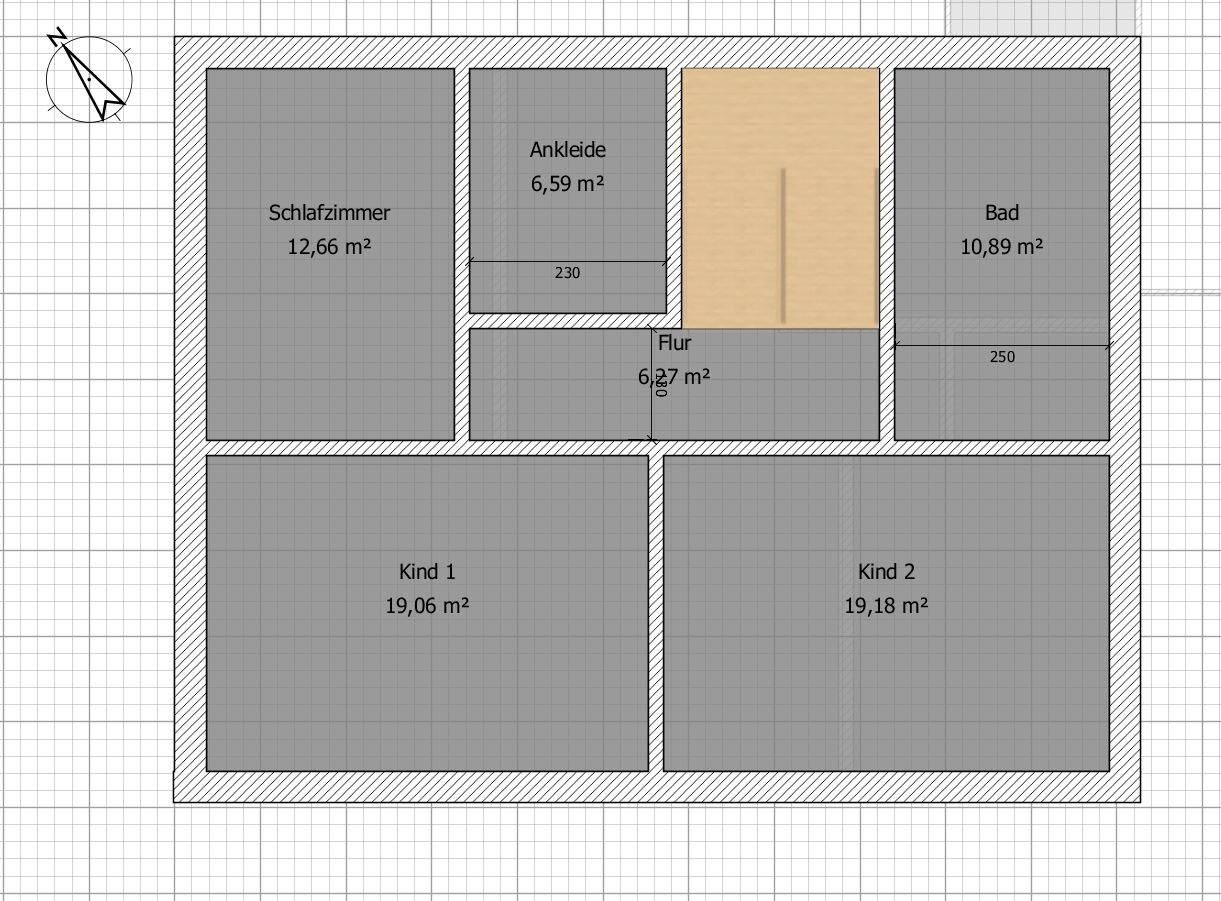

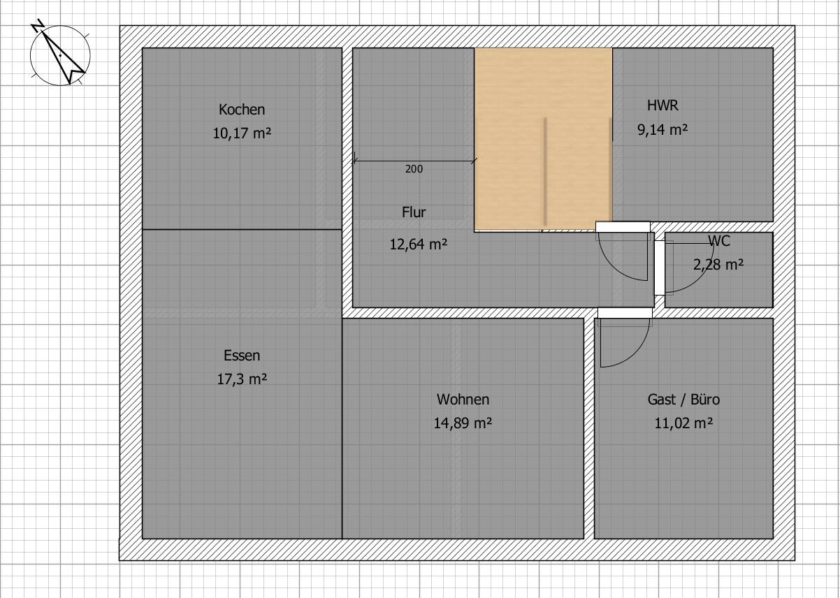

Overall, the floor plan isn’t bad, but I would probably opt for a more elongated house and place the children’s rooms towards the southwest (the forest?). Once you have furnished it, you can definitely say more. I’m curious how you plan to use that small living room corner.
About the current plan specifically: on the upper floor, the additional recess near the children’s bedroom doors is wasted space. You could reduce the hallway size and enlarge the rooms. Then shift the parents’ wall to the right to add a walk-in closet. The ground floor toilet could also free up some space for a wardrobe area. If a shower is not planned there, the room could be smaller.
I also find the windows much too small. You’re not living in a city with close neighbors. But please share the updated exterior views once you have them. If the children’s rooms face the forest, they could at least get reasonably sized windows.
