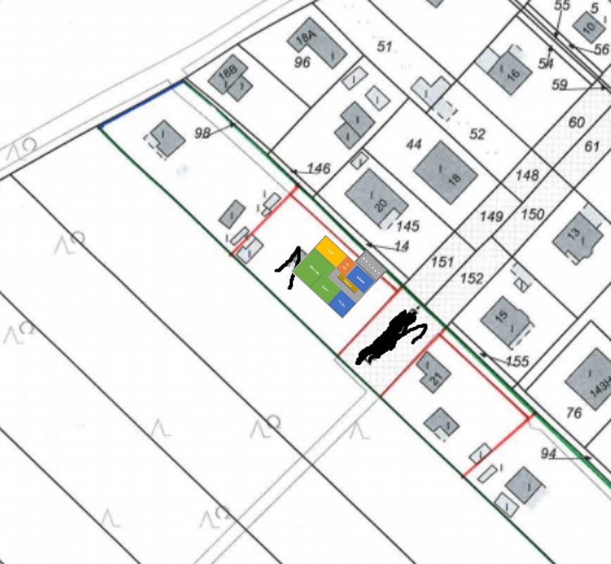

Plot size 819 sqm (8,815 sq ft), located in the southeast directly adjacent to the forest boundary.
In front of the plot is a small private road, and to the east a public road that ends in a dead end right in front of the property.
No slope
Floor area ratio 0.2
Building envelope, building line and boundary: 5 meters (16 ft) to the street, 3 meters (10 ft) to neighbors
Border development, carport separate from the house
Number of floors: 2
Roof type: shed roof / hip roof
Style: modern city villa
Orientation: southeast, due to the forest at the property boundary
Maximum heights / limits: maximum 8.25 meters (27 ft), with some negotiation possible with the building authority according to § 34

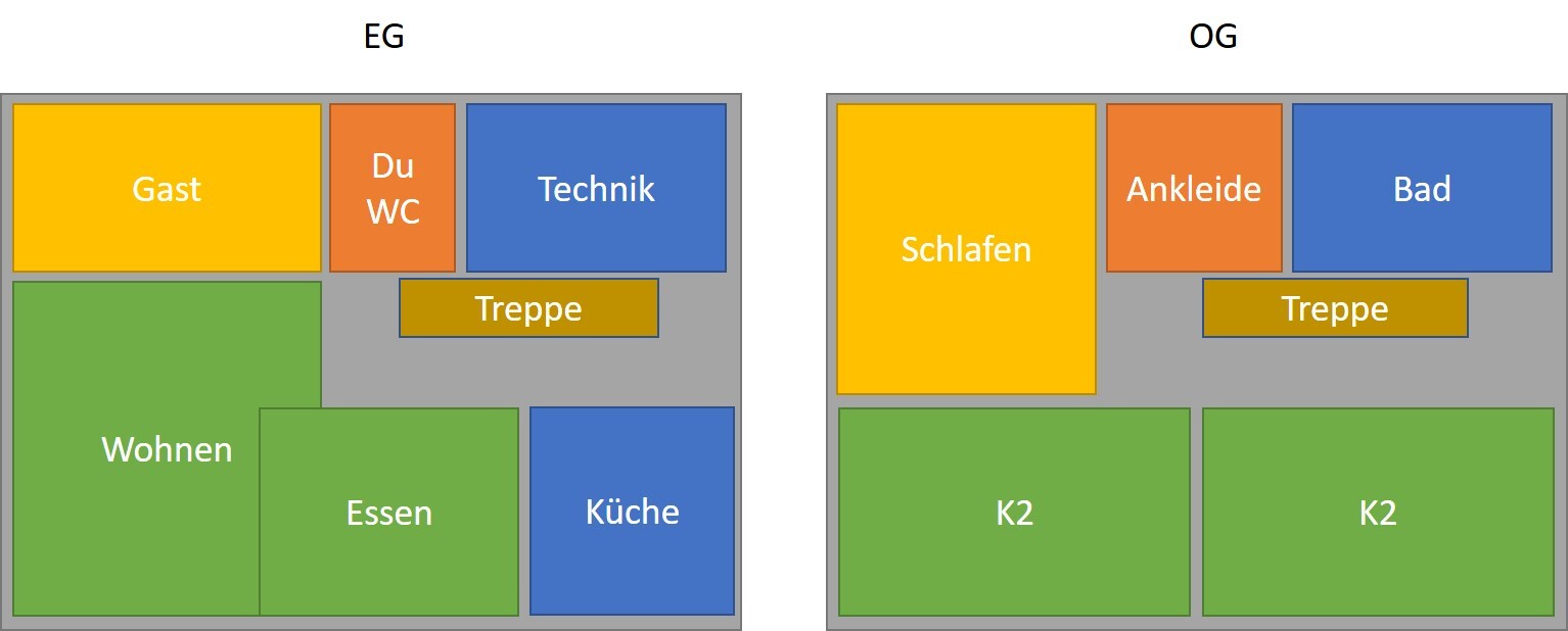

Lycana9 schrieb:
Does anyone have any comments on the floor plan?I already wrote some, but apparently no one’s asking? The house is incredibly large without offering real added value. The 3.20m (10.5 ft) in the living room—what’s the purpose of that corner if you don’t plan to furnish it? Where is the countertop space in the kitchen if you place the groceries, refrigerator, and oven all in tall cabinets? What’s the use of the remaining area in the open-plan room that doesn’t really have a clear function?
Is the TV supposed to be viewed from 5.70m (18.7 ft) or 3.20m (10.5 ft)?
Does everything and everyone have to pass through the living room to get something from the utility room?
180 sqm (1,938 sq ft) x 2000€
= 360,000€ excluding painting/flooring, energy-saving regulations, and plastering.
Anything that’s lower will cost you more during construction.
Plus upgrades on top.
Sure, our previous attempts with an elongated floor plan have unfortunately all failed miserably. The street to the north is a small private road, with only four other residents besides us, three of whom are only there on weekends. So, there is practically no through traffic. The street to the east is a dead-end that ends directly at our property and the forest. Therefore, there is no significant through traffic either. When the planes are not flying at BER, woodpeckers are the only source of noise.
I already mentioned that. But apparently, it’s not required?
The house is huge without delivering real added value. The 3.20 m (10.5 ft) in the living room? What’s the purpose of that corner if you don’t want to furnish it? Where is the countertop space in the kitchen if you put the fridge and oven inside tall cabinets? What is the rest of the open-plan area for, that doesn’t really have a clear purpose?
Are TV broadcasts transmitted over 5.70 m (18.7 ft) or 3.20 m (10.5 ft)?
Does everyone and everything need to pass through the living room when you have to get something out of the utility room?
180 sqm (1937 sq ft) x 2000 € = 360,000 without painter/flooring costs for energy-saving regulations and plastering.
Anything lower still costs extra during construction.
Plus upgrades. I will provide the sketch tomorrow. The 3.20 m (10.5 ft) corner in the living room is supposed to be the TV area. A large dining table will be placed between the kitchen island and the TV corner. The piano will go on the wall facing the hallway. I will try to draw it tomorrow.
