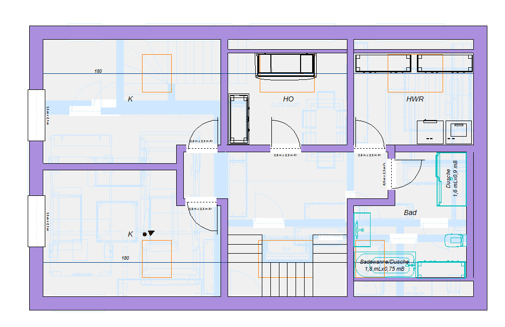

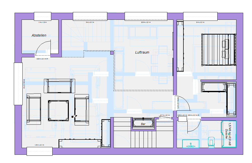

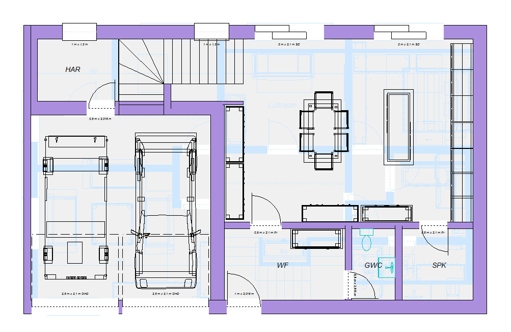

We have found a house near Frankfurt/Main where construction is about to begin. It is from a developer. Currently, there is an old house on the property which is being completely renovated. This will be converted into 3 condominiums. Our house will be a single-family home at the back with about 216 sqm (2,325 sq ft).
Two garages need to be integrated into the house, plus one parking space that we can purchase additionally.
Regarding the floor plan, apart from the external walls (a line with property boundary construction and 3.5 m (11.5 ft) to the neighbor) and the double garage, we have complete freedom. We have already modified the floor plan as we want to prepare the upper floor for potential rental at some point (an external staircase will probably not be approved). Hence the second internal staircase.
Basically, we are wondering how to best use the ground floor. Somehow I find it a bit small for cooking/living/dining. (Although I cannot verify the square meter figures, because based on the external dimensions and some calculations it should be about 49 sqm (527 sq ft) instead of approximately 44 sqm (474 sq ft), but I don’t know if the staircase is excluded).
Where is the best place to put a couch?
We also have questions about possible optimizations or mistakes we might have made. Does this all make sense? The architect implemented all of our requests without questioning whether they are practical or sensible. That makes us uncertain.
No basement, one garage for bicycles, and otherwise one room will be sacrificed.
We would like a kitchen island 🙂
The turnkey price is 769,000.
Thanks for your feedback!

Myrna_Loy4 Mar 2022 12:17And I would trust my gut feeling regarding the developer, the property, and the surroundings. Is the area family-friendly? What about daycare and schools? Where are playgrounds and open spaces? I wouldn’t let myself panic too much with the thought “what if we never find anything else.”
AHLK2022 schrieb:
I can’t leave the rest as is because the right wall of the garage has to extend all the way up to the roof. As a result, the living room needs to be smaller and the children’s rooms upstairs larger.In my opinion, the ground floor and first floor are relatively unproblematic if the beams on the first floor are sufficient. However, the attic without a utility room would need to be reconsidered. The washing machine has to go somewhere, and a home office was also necessary. Dry lightweight construction in the attic could probably solve the problem at the outset if that’s an option for you. I’m happy to brainstorm again, but I’d also advise not to feel pressured into making such a decision.AHLK2022 schrieb:
I would almost give up, I think that is very wise...
K a t j a schrieb:
Option with a slightly smaller air gap, … that’s why: don’t make it harder for the original poster to give up by trying new attempts.
I think that’s very wise...
... so don’t make it harder for the OP to give up by trying new things. I don’t think that matters. I’m a bit surprised by your strong aversion to the property and that you’re still awake. 😉
.. so don’t make it harder for the OP to move on with new attempts.I think the OP now has so many options, floor plans, and ideas for their project that they can make a well-informed decision. The beginning sounded very uncertain.
PS @K a t j a are you a housewife now 🙄
