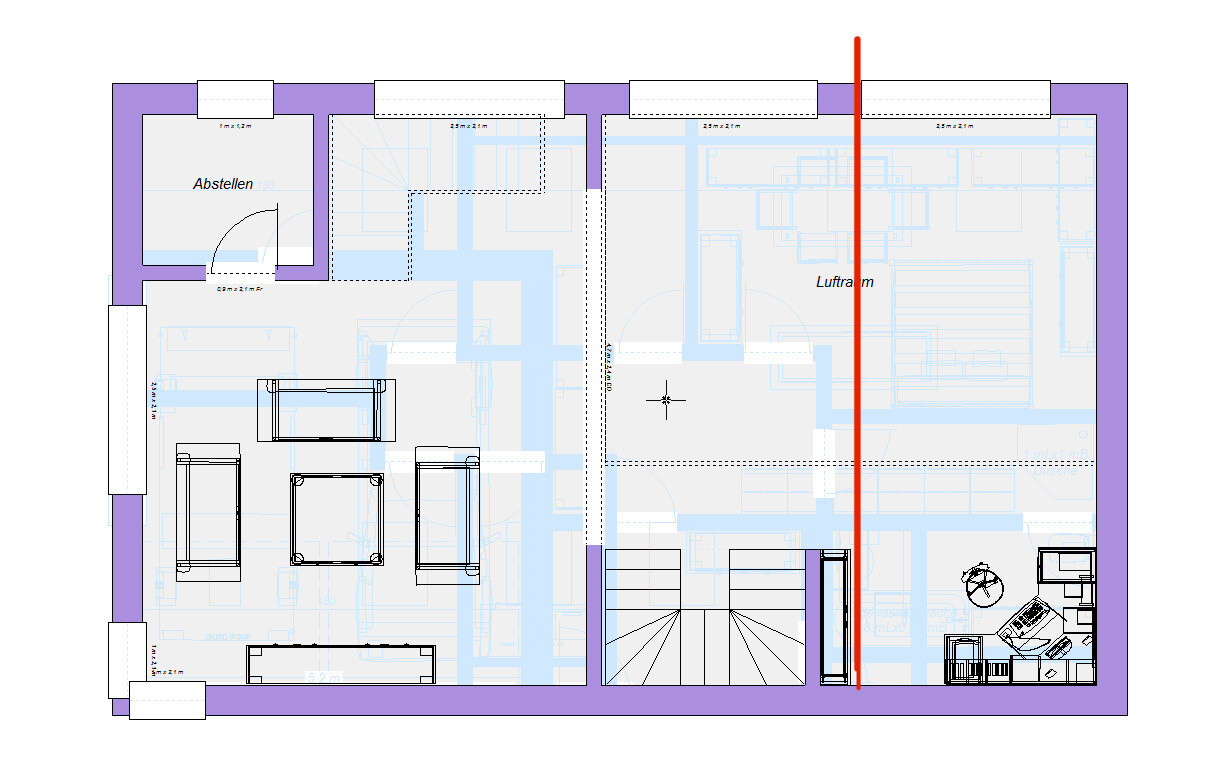

Beams will probably be necessary. We also needed them without a gallery or open space above. I wouldn’t drop the entire ceiling. I would just cover the beam and call it done. We even have a large fake beam. It somehow looked better and concealed the 4 or 5 cm (1.5 or 2 inches) lowered kitchen ceiling.
haydee schrieb:
Beams will probably be necessary. We needed them even without a gallery and open space. I wouldn’t suspend the entire ceiling. I would just cover the beam and be done with it. We even have a large fake beam. It somehow looked better and concealed the kitchen ceiling that was lowered by 4 or 5 cm (about 2 inches). Do I understand correctly that it is roughly as shown in red in the picture? (Very roughly)

AHLK2022 schrieb:
…the wall in the upper floor living room would have to be moved to the garage wall, and the wall between the staircase and the study would have to be shifted to align with the wall below in the ground floor toilet.I’m afraid this will not be beneficial for the living room upstairs at all.
