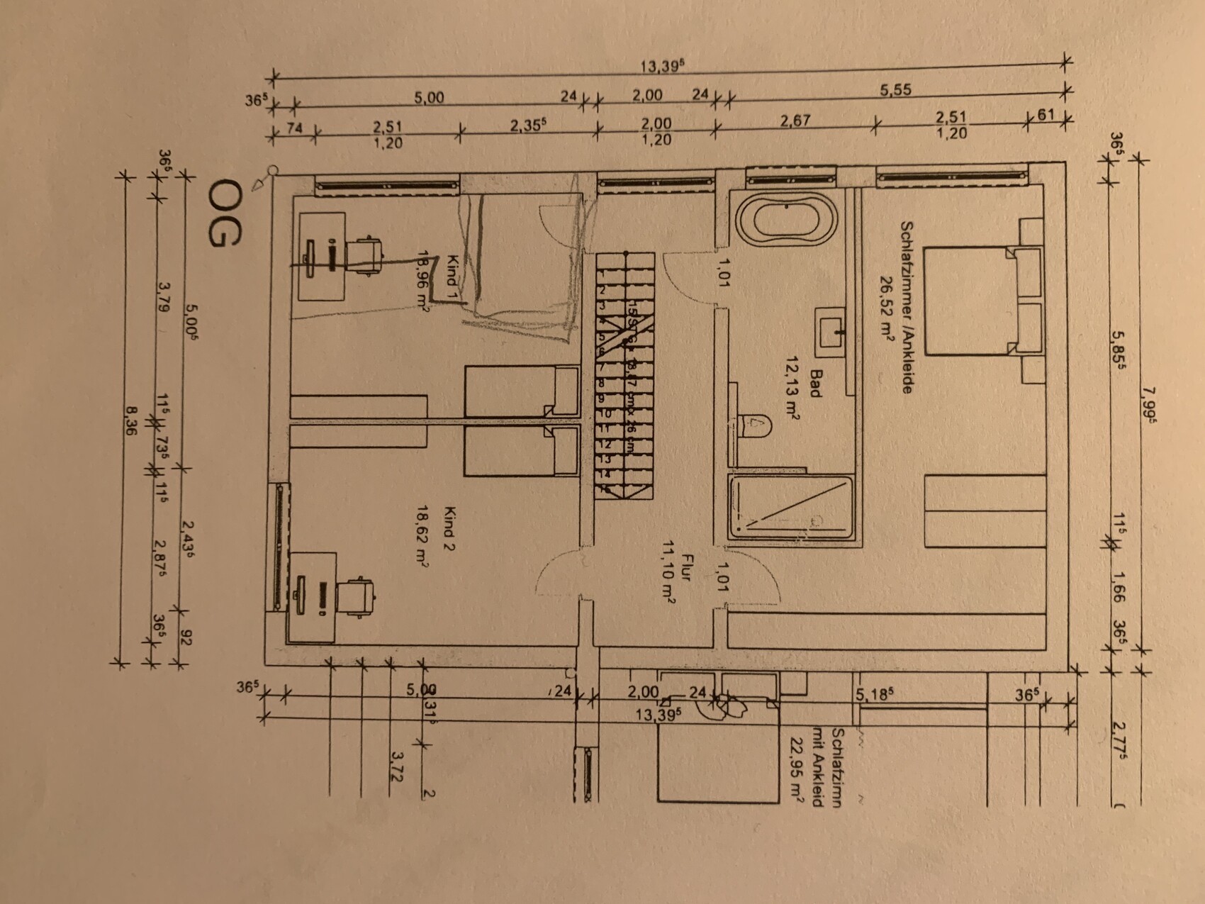

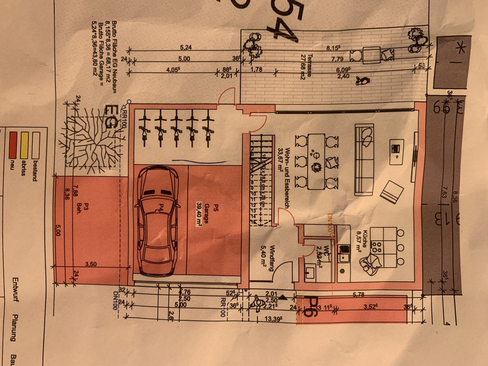

We have found a house near Frankfurt/Main where construction is about to begin. It is from a developer. Currently, there is an old house on the property which is being completely renovated. This will be converted into 3 condominiums. Our house will be a single-family home at the back with about 216 sqm (2,325 sq ft).
Two garages need to be integrated into the house, plus one parking space that we can purchase additionally.

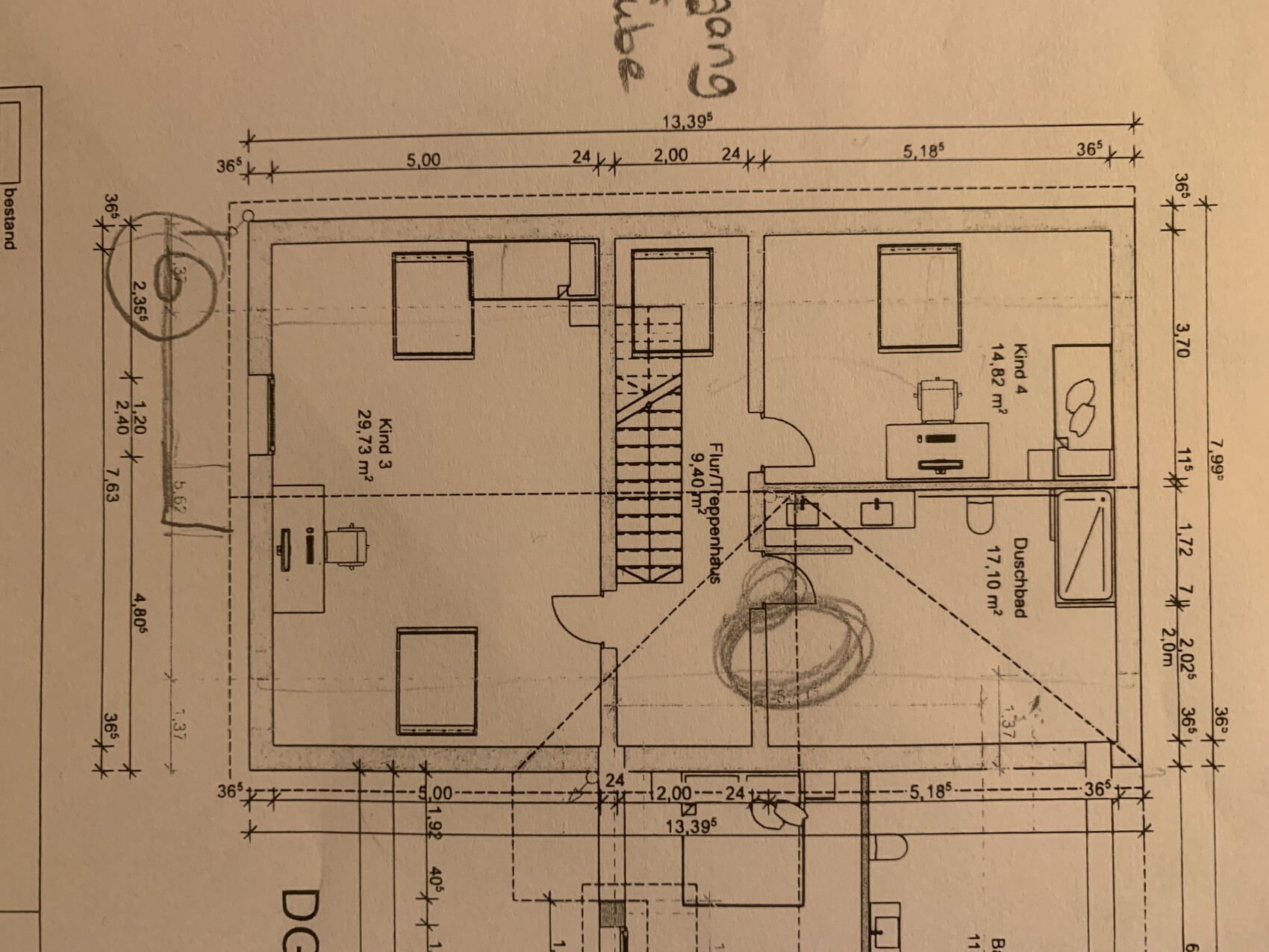

Regarding the floor plan, apart from the external walls (a line with property boundary construction and 3.5 m (11.5 ft) to the neighbor) and the double garage, we have complete freedom. We have already modified the floor plan as we want to prepare the upper floor for potential rental at some point (an external staircase will probably not be approved). Hence the second internal staircase.
Basically, we are wondering how to best use the ground floor. Somehow I find it a bit small for cooking/living/dining. (Although I cannot verify the square meter figures, because based on the external dimensions and some calculations it should be about 49 sqm (527 sq ft) instead of approximately 44 sqm (474 sq ft), but I don’t know if the staircase is excluded).
Where is the best place to put a couch?
We also have questions about possible optimizations or mistakes we might have made. Does this all make sense? The architect implemented all of our requests without questioning whether they are practical or sensible. That makes us uncertain.
No basement, one garage for bicycles, and otherwise one room will be sacrificed.
We would like a kitchen island 🙂
The turnkey price is 769,000.
Thanks for your feedback!

We have already modified the floor plan, as we want to prepare the upper floor for rental at some point. It seems to me that you have already made too many changes, and the “original” probably was not a masterpiece either, but at least not such a flawed mess. Without the complex overall concept, I would have only suggested rearranging the “house” differently (for example, not designating the attic as a separate apartment). However, under the current circumstances, I would advise against recommending anything specific and would only suggest walking away from the offer. Let the developer deal with this problem alone and continue searching on your own. Here, practically worthless living space is being built solely to maximize the economic gain from the property. If I were the developer, I would tip my hat to the colleague for this stunt – but as a customer-focused building consultant, I find this offer frankly audacious.

The floor plan is too messed up to achieve anything with small changes. But if you are looking for a real, potential second living unit—not just trying to get a second subsidy—then I would build it in a way that allows adding an entrance and staircase in the storage room by the garage. Then adjust the floor plan upstairs accordingly.
TmMike_2 schrieb:The architect was quite careless with the interior layout. He just places items in the room… we would arrange things differently. Of course, not putting chair backs directly in front of the TV.
With 216 m² (2,322 sq ft), I would also design the main living area more generously. How tight is the space by the TV wall?
Our kitchen, dining, and living area stretches over almost 12 m length (39 ft).
That’s not small, but not large either, since this room also includes a piano, a fireplace, and a 3 m (10 ft) long table placed lengthwise.
haydee schrieb:We had considered creating a cloakroom in the “general hallway” under the spiral staircase. You could also slide a stroller under there. It won’t always be there anyway. Jackets could be hung on the left wall. But yes, the tenant would have to walk past that area.

There is little space downstairs for the size of the house, and upstairs everything feels a bit overwhelming.
You come home with a Maxi-Cosi and a child by the hand. Where do you put everything?
The dining area consists of two benches and a relatively narrow table. A high chair or sliding a chair away to make room for a baby bump is not an option.
