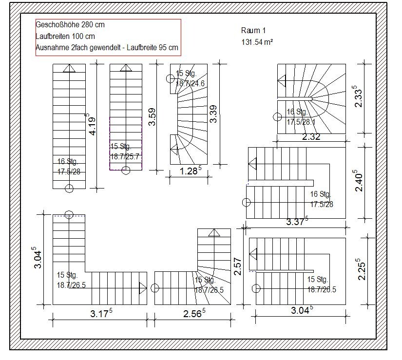

@Grym .. I had already posted this before:
Technical floor plan of a building with stairs, walls, and dimensions
A clear ceiling height of 270 cm (106 inches) should correspond to a floor-to-floor height of about 295 cm (116 inches), which is 15 cm (6 inches) more than in my examples. See the staircase in the upper right corner; I don’t think your staircase will fit well there.
